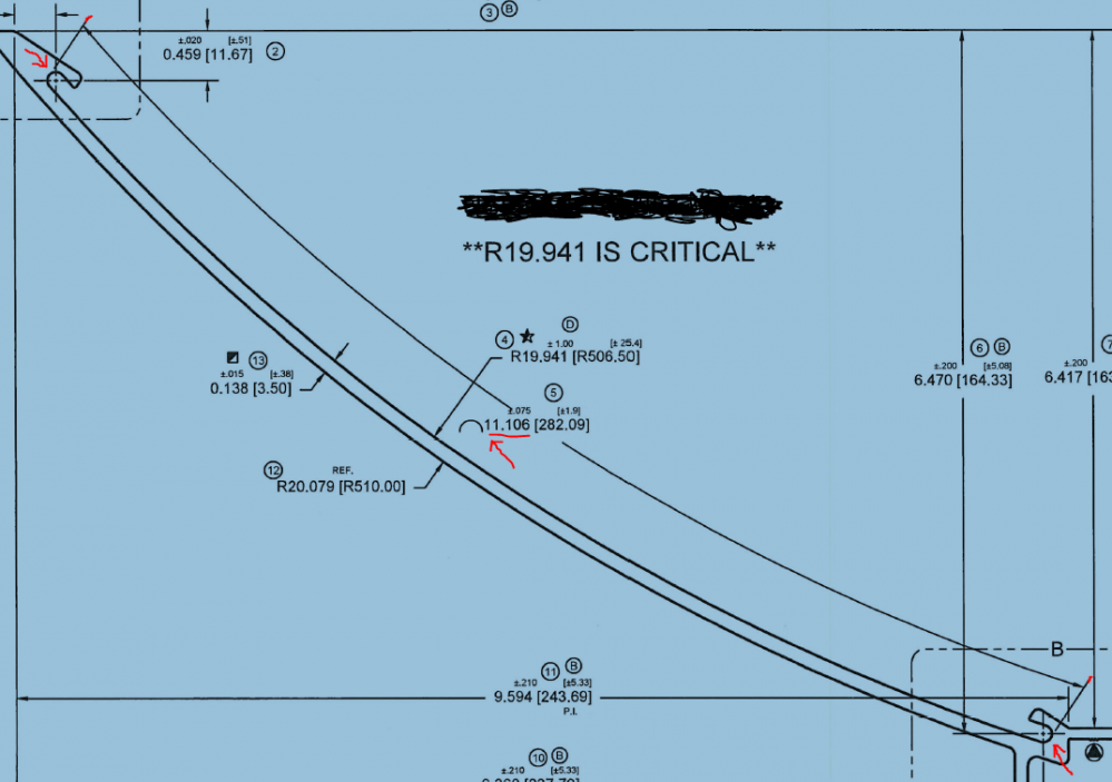

[AG...] Posted March 12, 2025 Share Posted March 12, 2025 How to inspect this? I see its coming from the tangents of the Diameters. When i use all features for curve i am short the halves of the small diameters. I am probably overthinking this? Thank you for any direction on this, much appreciated. Link to comment https://qualityforum.zeiss.com/topic/22727-radius-length-looks-like-profile-of-a-line/ Share on other sites More sharing options...
[Ma...] Posted March 12, 2025 Share Posted March 12, 2025 It should be length of arc - it does not look like line profile callout. I would ask designer/customer about that. Otherwise - measuring that like curve and then report curve length would do that. Link to comment https://qualityforum.zeiss.com/topic/22727-radius-length-looks-like-profile-of-a-line/#findComment-128163 Share on other sites More sharing options...
[AG...] Posted March 12, 2025 Author Share Posted March 12, 2025 So, yes to me i am seeing arc length also. So measure like curve as in recall the 2 small diameters and the larger diameter also and report a curve length? Sorry i have been teaching myself curves had the basic class back when it first came out. So i am trying to get up to speed. Thank you on the information. Link to comment https://qualityforum.zeiss.com/topic/22727-radius-length-looks-like-profile-of-a-line/#findComment-128177 Share on other sites More sharing options...
[Ma...] Posted March 12, 2025 Share Posted March 12, 2025 I am not sure of start and end point - but it can be done with single curve. From customer side - i would like to see two marks like for curves indicating boundaries. It's drawn like it should include part of smaller radii. On Calypso there is "Curve length". Is that drawing comming from customer or your internal designers? Rather ask, than report wrong results. Also, if you have a model, then you can try to investigate - model should be made as nominals from drawing, so you can create curves and try to find out what is close to 11.106 inch( 282.09mm ) Link to comment https://qualityforum.zeiss.com/topic/22727-radius-length-looks-like-profile-of-a-line/#findComment-128179 Share on other sites More sharing options...
[AG...] Posted March 18, 2025 Author Share Posted March 18, 2025 Thank you for the information. I was trying to pick this up 2D for the length. I was getting 10.86 with 2D, i opened up the 3D model and started with the curve and i was getting 10.987 with Curve Length. So i was able to accomplish what you were helping me with. This is a customer drawing, comparing Radii to Radii cuts. It was not so much the length we were looking for but the large Radii to compare. Much appreciated learned Curve Length and hopefully i will be able to get into the curves class again and refresh my memory some. Link to comment https://qualityforum.zeiss.com/topic/22727-radius-length-looks-like-profile-of-a-line/#findComment-128537 Share on other sites More sharing options...
[Mi...] Posted March 18, 2025 Share Posted March 18, 2025 If you need arc length you can use a formula to convert the Chord Length that you'll get from a Polar 2D Distance or Caliper distance, depending if it's from the centers of those circles or edges Result Element formula... =(rad((arcsin(CHORD_LENGTH/DIAMETER)*2))*RADIUS) =(rad((arcsin(CHORD_LENGTH/39.882)*2))*19.941) Link to comment https://qualityforum.zeiss.com/topic/22727-radius-length-looks-like-profile-of-a-line/#findComment-128545 Share on other sites More sharing options...
[Ri...] Posted March 18, 2025 Share Posted March 18, 2025 Thanks Micheal. As for the arc length, if it was a Profile of a line, it would be inside an FCF. Attached is an example of arc length (Note the dimension is curved, it doesn't have to be shown curved). The Arc Length requirement is shown with a tolerance. Link to comment https://qualityforum.zeiss.com/topic/22727-radius-length-looks-like-profile-of-a-line/#findComment-128561 Share on other sites More sharing options...
