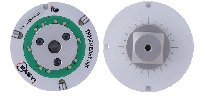

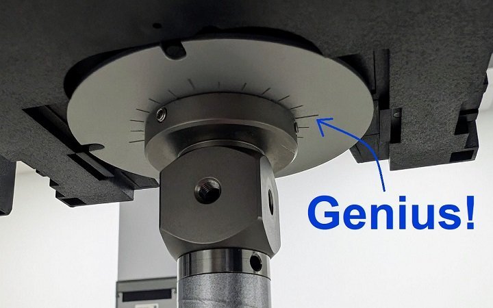

[Je...] Posted March 18, 2025 Share Posted March 18, 2025 (edited) Please sign in to view this quote. Hi Nicholas. I think it's great that you're interesting in finding optimal solutions for XTR Gold probe heads. You were right to question the feedback you were given that claimed that only Zeiss OEM part# 600660-8365-000 could be used on VAST Gold sensors. One solution that I love to use for VAST probe sockets is made by itpstyli.com and features laser-engraved indexing marks that assist with setup. The part number is: TP M5 MEASY 002 and the link to this product is: https://www.itpstyli.com/OnlineShop/ProductDetails/TPM5MEASY002 They have become my standard for use on Zeiss Prismo cmms. Itpstyli also has a few other models of adapter plates that work with VAST Gold sensors. Edited March 18, 2025 Link to comment https://qualityforum.zeiss.com/topic/22753-vast-xtr-gold-adapter-plate-and-probe-socket-compatibility/#findComment-128523 Share on other sites More sharing options...
