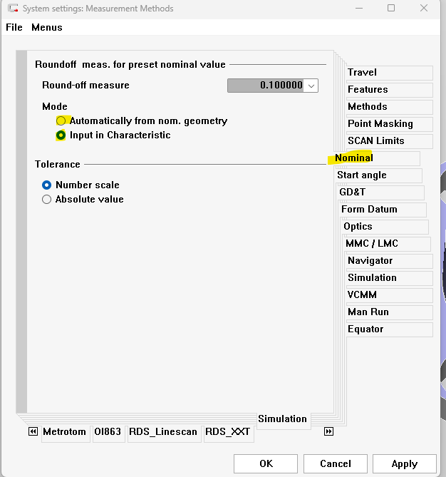

[Ri...] Posted March 17, 2025 Share Posted March 17, 2025 I don't know how this would have been set, I never use it, also I don't know how to turn it off. Any help is appreciated. Link to comment https://qualityforum.zeiss.com/topic/22767-nominal-values-contradict-the-nominal-geometry/ Share on other sites More sharing options...
[Ma...] Posted March 17, 2025 Share Posted March 17, 2025 I have never seen this. Does it complain about "Nominal position" is not same as Circle1 nominals in datums alignment ( Cylinder2_G - Plane2_K - Circle1_F )? Link to comment https://qualityforum.zeiss.com/topic/22767-nominal-values-contradict-the-nominal-geometry/#findComment-128395 Share on other sites More sharing options...
[Ma...] Posted March 17, 2025 Share Posted March 17, 2025 Could it be this: Link to comment https://qualityforum.zeiss.com/topic/22767-nominal-values-contradict-the-nominal-geometry/#findComment-128397 Share on other sites More sharing options...
[Ri...] Posted March 17, 2025 Author Share Posted March 17, 2025 Please sign in to view this quote. Correct. Link to comment https://qualityforum.zeiss.com/topic/22767-nominal-values-contradict-the-nominal-geometry/#findComment-128401 Share on other sites More sharing options...
[Ri...] Posted March 17, 2025 Author Share Posted March 17, 2025 Please sign in to view this quote. I thought it was this, it seems it's not. My setting for all programs (They do not have this issue) is: Automatically from nom. geometry Absolute value Link to comment https://qualityforum.zeiss.com/topic/22767-nominal-values-contradict-the-nominal-geometry/#findComment-128403 Share on other sites More sharing options...
[Ri...] Posted March 17, 2025 Author Share Posted March 17, 2025 This same program is now getting a "PiWeb doesn't support the amount mode?" (Posted in PiWeb forum). Link to comment https://qualityforum.zeiss.com/topic/22767-nominal-values-contradict-the-nominal-geometry/#findComment-128405 Share on other sites More sharing options...
[Ma...] Posted March 17, 2025 Share Posted March 17, 2025 Please sign in to view this quote. Too many errors 😄 restart calypso 😄 Link to comment https://qualityforum.zeiss.com/topic/22767-nominal-values-contradict-the-nominal-geometry/#findComment-128407 Share on other sites More sharing options...
[Ri...] Posted March 17, 2025 Author Share Posted March 17, 2025 Marcel was right in a message; I had to set this thru the "Characteristic Settings" menu. "Nominal Mode", set to "Input in Characteristic". It seems changing this via "Measuring Methods" and "Nominal" had no effect. Using "Number scale" also removed the PiWeb error. Link to comment https://qualityforum.zeiss.com/topic/22767-nominal-values-contradict-the-nominal-geometry/#findComment-128425 Share on other sites More sharing options...
