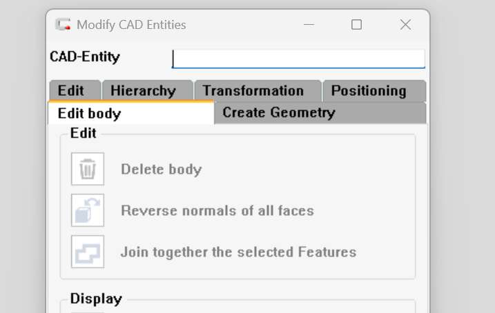

[Lu...] Posted March 17, 2025 Share Posted March 17, 2025 hi everyone, today I was trying to remove a model from an existing program to make an update. surprisingly, the edit model icon is grayed out.... any ideas of why ..? current versions 2024 version 7.8.08 Link to comment https://qualityforum.zeiss.com/topic/22771-cad-model-editing-is-grayed-out/ Share on other sites More sharing options...
[Ri...] Posted March 17, 2025 Share Posted March 17, 2025 Go into "Hierarchy", select the model and delete it. Link to comment https://qualityforum.zeiss.com/topic/22771-cad-model-editing-is-grayed-out/#findComment-128419 Share on other sites More sharing options...
[Lu...] Posted March 17, 2025 Author Share Posted March 17, 2025 thank you Richard....! before it would just populate automatic... Link to comment https://qualityforum.zeiss.com/topic/22771-cad-model-editing-is-grayed-out/#findComment-128427 Share on other sites More sharing options...
