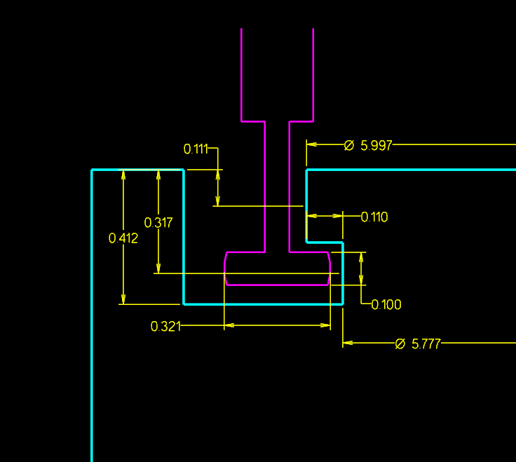

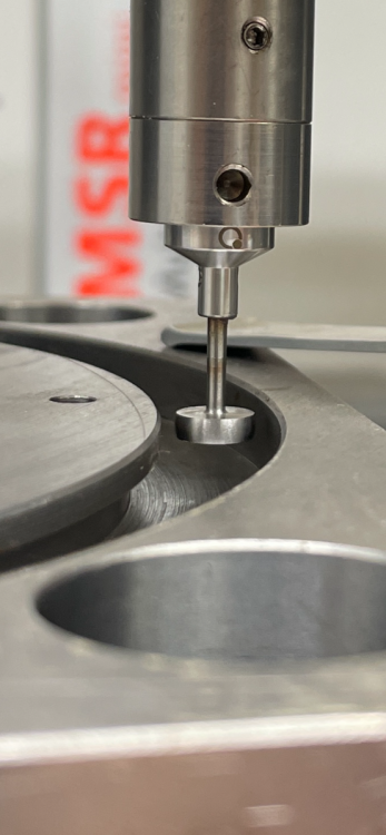

[Zo...] Posted March 17, 2025 Share Posted March 17, 2025 Trying to qualify a custom disc stylus on our Contura with VAST XT for the first time and it isn't recognized by Calypso. I tried following instructions online, got a reference probe copied, Diameter adjusted to the disc diameter, set up a ring gage on the table, ran a program to measure the ID, but when I insert the disc probe, the control doesn't recognize it, so cannot run it to compare the measurements, as the instruction said. Can anyone provide proven steps to set up a disc stylus to measure ID groove with a step? Link to comment https://qualityforum.zeiss.com/topic/22775-disc-stylus-qualifying/ Share on other sites More sharing options...

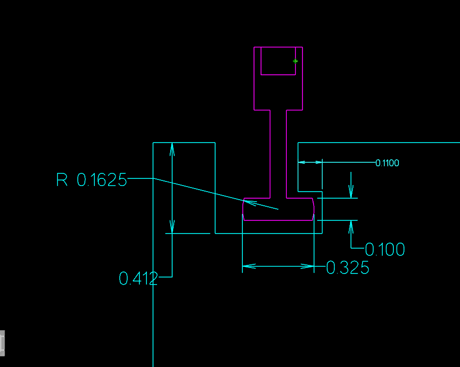

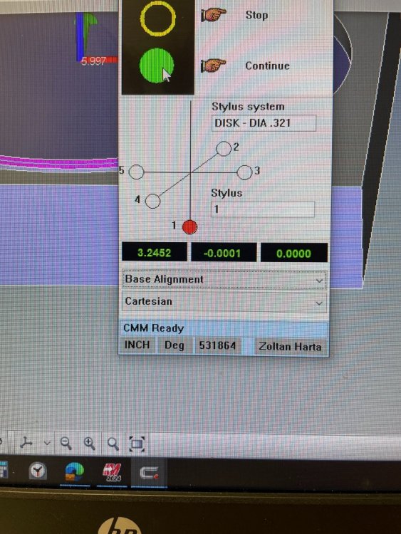

[Zo...] Posted March 18, 2025 Author Share Posted March 18, 2025 I was able to qualify the stylus manually, but I wasn't able to define the disc diameter and thickness. I didn't think they need to be defined but the initial measurements are off, by a lot, like the Z move for the rim diameter should be Z -.111, but in reality it is at -0.061, which would make sense taking half the thickness of the .10 disc into consideration, but in my view, it should be -.111+.05=-.161, and it isn't. So I am still trying to fine tune it and verify that it setup properly. Not sure how, because I am not sure of what the stylus is missing. It was manually calibrated, seemed happy, but apparently it isn't making ME happy. I, by the way am mostly interested in measuring DIA 5.777, hence the need for the custom-made disc, precision ground in house from M42 stock, all other dimensions can be done with standard probes. Link to comment https://qualityforum.zeiss.com/topic/22775-disc-stylus-qualifying/#findComment-128497 Share on other sites More sharing options...
[Zo...] Posted March 18, 2025 Author Share Posted March 18, 2025 I am not sure where the manually qualified disc probe's bottom is assumed to be, at what Z depth, my guess would be +0.05 with a 0.10 thickness, but this is what the "Z zero" looks like on the table, with reference to the base alignment: Link to comment https://qualityforum.zeiss.com/topic/22775-disc-stylus-qualifying/#findComment-128501 Share on other sites More sharing options...

[Du...] Posted March 18, 2025 Share Posted March 18, 2025 Not 100% sure but i do believe Z zero would be the bottom of your theoretical sphere, its been a while since ive used one on a non CAD program but i think you would need to compensate for that. Link to comment https://qualityforum.zeiss.com/topic/22775-disc-stylus-qualifying/#findComment-128509 Share on other sites More sharing options...
