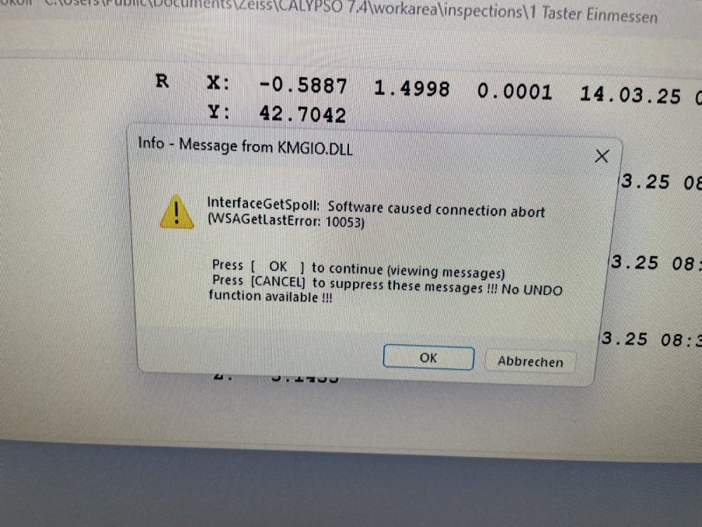

[Ro...] Posted March 18, 2025 Share Posted March 18, 2025 Hallo ihr lieben, ich habe aktuell auf meiner alten UMC850 folgendes problem. Während der Messung, unterschiedliche Teile und Programme kommt sporadisch folgende Fehler Meldung (Siehe Bild) wer kann mir helfen wo liegt das Problem. Herzlichen Dank Link to comment https://qualityforum.zeiss.com/topic/22779-interface-error/ Share on other sites More sharing options...
[Za...] Posted March 20, 2025 Share Posted March 20, 2025 (edited) If the issue is sporadic, it's possible your ethernet cable is shorting out and you need a replacement to continue constant communication. Additionally, I'd check on your IP settings. Relevant Knowledge Base Article on resolving connection problems: https://portal.zeiss.com/knowledge-base?id=454224 If that does not resolve the issue, this article directly discussing the KMGIO.dll file may help as well: https://portal.zeiss.com/knowledge-base?id=579796 Edited March 20, 2025 Link to comment https://qualityforum.zeiss.com/topic/22779-interface-error/#findComment-128733 Share on other sites More sharing options...
