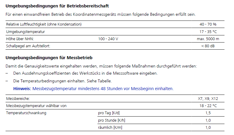

[Ri...] Posted March 18, 2025 Share Posted March 18, 2025 (edited) Are there sound levels and or frequency levels that need to be monitored for CMM's with the VAST XT (circa 2005) and XTR (circa 2022) sensors? We have a new assembly equipment that runs large hydraulic pumps, they are quite loud (120Db+), the CMM lab is close and enclosed possibly reducing the Db to half? This is one of several planned for the area near this lab. With the sound there may be a frequency level created by the sound. Any information is helpful. Edited March 18, 2025 Link to comment https://qualityforum.zeiss.com/topic/22789-sound-levels-and-or-frequency-ranges/ Share on other sites More sharing options...
[Ma...] Posted March 18, 2025 Share Posted March 18, 2025 Hello Richard, i found this for a Contura: But that's only for "working conditions", you might still have an influence in your accuracy. Best Regards Marcel Link to comment https://qualityforum.zeiss.com/topic/22789-sound-levels-and-or-frequency-ranges/#findComment-128525 Share on other sites More sharing options...
