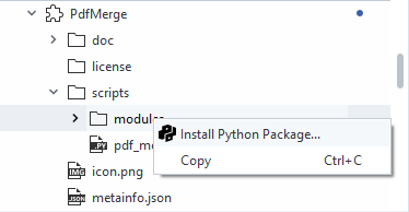

[Ra...] Posted March 19, 2025 Share Posted March 19, 2025 Hi, I need help installing a Python library "pypdf" to combine pdf from different reports. Ultimately I want to make a script that combines pdf files from several reports into one file and save it under a different name, Each pdf file or page is always to be added to the end of the file ready to be save as. I work on GOM Scanbox 6, Atos 2020 nad 20222. Sample script in attachment - pdf.txt pdf.txt Link to comment https://qualityforum.zeiss.com/topic/22801-python-pdf-library-installation-script/ Share on other sites More sharing options...
[Ma...] Posted March 31, 2025 Share Posted March 31, 2025 (edited) Hi Please sign in to view this username. , You already provided a mostly working solution. In ZEISS INSPECT 2025, you install Python packages with the App Editor as follows: ZEISS INSPECT 2025 provides the `choose_file()` command (see Selecting a file or folder), which can be configured interactively to request an existing folder, an existing file or a new file as in the following script: import gom import os from PyPDF2 import PdfMerger def merge_pdfs_with_last_file(input_folder, last_file, output_file): # Creating a PdfMerger object merger = PdfMerger() # Retrieving all PDF files in the folder pdf_files = [file for file in os.listdir(input_folder) if file.endswith('.pdf')] # Sorting files alphabetically (optional) pdf_files.sort() # Adding PDF files to the PdfMerger object for pdf in pdf_files: pdf_path = os.path.join(input_folder, pdf) if os.path.abspath(pdf_path) != os.path.abspath(last_file): # Skipping the file specified to be at the end merger.append(pdf_path) # Adding the file that should be at the end merger.append(last_file) # Saving the merged PDF file merger.write(output_file) merger.close() print(f"Merged PDF files and saved as '{output_file}'") if __name__ == "__main__": # Location of the folder with PDF files input_folder=gom.script.sys.choose_file (selection_type='select directory') # Path to the file that should be added at the end last_file=gom.script.sys.choose_file ( file_types=[['*.pdf', 'PDF files'], ['*.*', 'All files']], file_types_default='*.pdf', folder='', file='', selection_type='load file') # Location of the output file output_file=gom.script.sys.choose_file ( file_types=[], file_types_default='', folder='', file='', selection_type='new file') merge_pdfs_with_last_file(input_folder, last_file, output_file) As an alternative, you create a user-defined dialog with File Widgets, which also works in older versions of ZEISS INSPECT. Best regards, Matthias Edited March 31, 2025 1 Link to comment https://qualityforum.zeiss.com/topic/22801-python-pdf-library-installation-script/#findComment-129289 Share on other sites More sharing options...
[Ma...] Posted March 31, 2025 Share Posted March 31, 2025 BTW: You can also use pypdf (which is newer than PyPDF2) with minimal modifications: [...] from pypdf import PdfWriter def merge_pdfs_with_last_file(input_folder, last_file, output_file): # Creating a PdfWriter (formerly PdfMerger) object merger = PdfWriter() [...] 1 Link to comment https://qualityforum.zeiss.com/topic/22801-python-pdf-library-installation-script/#findComment-129297 Share on other sites More sharing options...
[Ra...] Posted April 1, 2025 Author Share Posted April 1, 2025 (edited) Hi Please sign in to view this username. Thanks for your help and information. I downloaded the pypdf package, during installation I don't want to overwite data the current py files, because the installed ones are used in other processes. I would like to be sure that my pypdf package will not affect the work of Atos and the scanning robot, so the installation must be on the user folder - "test pypdf". This is the first time I install the py package on Atos Scanbox. Edited April 1, 2025 Link to comment https://qualityforum.zeiss.com/topic/22801-python-pdf-library-installation-script/#findComment-129369 Share on other sites More sharing options...
