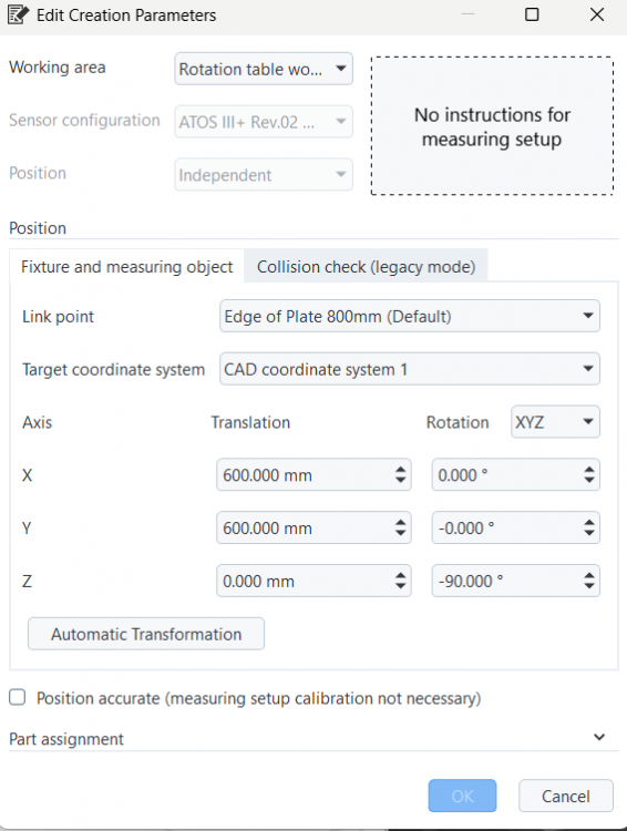

Insert picture
  • 10 months later...
You should be able to do this by modifying the measurement setup.
The measurement setup must not be active when the template is saved. If you only have 1, and you can't make it non-active, just create and then delete a new measurement setup. The instructions display when the measurement setup becomes active, that's why it can't be active when it's saved.

"I'm not sure if this helps, but you can try using the Piano icon at the top. From there, go to Operator information at CNC startup and click on Select to insert the image. Every time you click on Start CNC, you will find the image under User information on the CNC startup screen.
PIANO > OPERATOR INFORMATION AT CNC STARTUP > SELECT."
