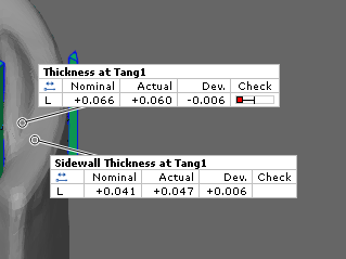

[Br...] Posted March 20, 2025 Share Posted March 20, 2025 Can anyone tell me how to calculate the difference between these two measurements, and create a similar box on screen displaying the result? Seems like it should be an easy-do, but I'm having trouble finding this function. Appreciate any assist! Link to comment https://qualityforum.zeiss.com/topic/22829-calculation-of-delta-from-two-different-measurements/ Share on other sites More sharing options...

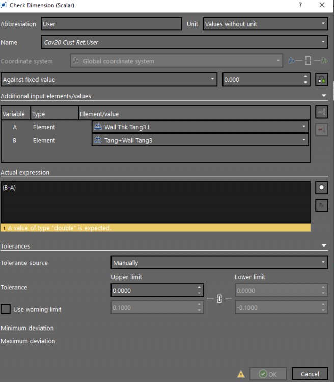

[Br...] Posted March 24, 2025 Author Share Posted March 24, 2025 Reached out to support last week, awaiting reply but I actually need to figure out this to add to a report today. Does anyone know how to build this formula? The simple approach seen below does not provide needed results. Appreciate any assist. Link to comment https://qualityforum.zeiss.com/topic/22829-calculation-of-delta-from-two-different-measurements/#findComment-128923 Share on other sites More sharing options...

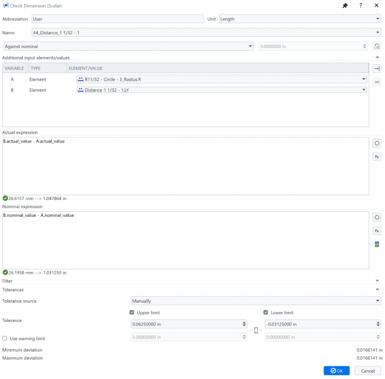

[Ri...] Posted March 24, 2025 Share Posted March 24, 2025 Please sign in to view this quote. Here's an example of how it is handled. You are close, you just need to tell it which piece of information from Variable A and Variable B you want for the actual expression formula. As you can see for the Actual expression, change your formula to: B.actual_value - A.actual_value For the Nominal expression, either enter it manually or use the following formula: B.nominal_value - A.nominal_value Also make sure to set your unit the specific type of measurement you are working with. Link to comment https://qualityforum.zeiss.com/topic/22829-calculation-of-delta-from-two-different-measurements/#findComment-128933 Share on other sites More sharing options...
[Br...] Posted March 25, 2025 Author Share Posted March 25, 2025 Thanks all for the replies, support also got back with me, got it worked out. Of note for anyone else utilizing: It was also failing on my end to because I was attempting to pull from "Dimensions", instead of "Dimensions (scalar). Appreciate the group and support! Link to comment https://qualityforum.zeiss.com/topic/22829-calculation-of-delta-from-two-different-measurements/#findComment-128951 Share on other sites More sharing options...
