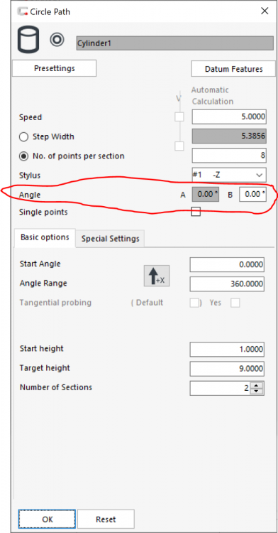

[Sh...] Posted March 25, 2025 Share Posted March 25, 2025 Is there a way to rotate a ZAS head to 0 Degrees via PCM? Link to comment https://qualityforum.zeiss.com/topic/22861-pcm-post-setting-for-zas/ Share on other sites More sharing options...
[Cl...] Posted March 25, 2025 Share Posted March 25, 2025 Not sure what a ZAS head is? I use this (post settings) to rotate my rotary to zero. rotateReference(0) Link to comment https://qualityforum.zeiss.com/topic/22861-pcm-post-setting-for-zas/#findComment-128967 Share on other sites More sharing options...
[Sh...] Posted March 25, 2025 Author Share Posted March 25, 2025 Zeiss Articulating Stylus. Similar to the RDS but only rotates in one direction. 1 Link to comment https://qualityforum.zeiss.com/topic/22861-pcm-post-setting-for-zas/#findComment-128969 Share on other sites More sharing options...
[Ch...] Posted March 25, 2025 Share Posted March 25, 2025 Shawn, does ZAS have different individual stylus like an RDS? If so, I'd just recommend putting a 'stop' intermediate point with stylus at A0B0 position in the last feature - or perhaps use an 'End Park Position'. With PCM - I suppose we could theoretically 'change Stylus', but not knowing where the probe is when this id changed could be dangerous. Link to comment https://qualityforum.zeiss.com/topic/22861-pcm-post-setting-for-zas/#findComment-128973 Share on other sites More sharing options...
[Ri...] Posted March 25, 2025 Share Posted March 25, 2025 The ZAS behaves the same way as an RDS with CAA turned on. I'm sure there is a command to set the stylus angle, but I'm a novice at PCM, so I haven't ran into that yet. Link to comment https://qualityforum.zeiss.com/topic/22861-pcm-post-setting-for-zas/#findComment-128975 Share on other sites More sharing options...
[Ch...] Posted March 25, 2025 Share Posted March 25, 2025 if you have a stylus qualfiied at this angle, we can use PCM to set this stylus active. to actually rotate - I'd have to investigate - probably do-able. Link to comment https://qualityforum.zeiss.com/topic/22861-pcm-post-setting-for-zas/#findComment-128979 Share on other sites More sharing options...
[Ri...] Posted March 25, 2025 Share Posted March 25, 2025 No active stylus. You just set the angle inside of the feature strategy. Link to comment https://qualityforum.zeiss.com/topic/22861-pcm-post-setting-for-zas/#findComment-128981 Share on other sites More sharing options...
