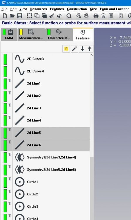

[Ge...] Posted March 25, 2025 Share Posted March 25, 2025 On our Contura when Selecting Features and Characteristics at the machine each feature and or characteristic stays highlighted until you open a single feature and then close it out. Unable to use CTRL/SHIFT to select multiple features. This has been occurring (a constant) since I began working on the machine in DEC 2024. I was hoping our software upgrade to 2024 would have corrected the issue but it did not. Has anyone ever ran into this and can give some advice on how to correct this? Photo uploaded to show multiple highlighted features. Link to comment https://qualityforum.zeiss.com/topic/22877-featurescharacteristics-stay-highlighted/ Share on other sites More sharing options...
[Ke...] Posted March 25, 2025 Share Posted March 25, 2025 Bit of a long shot, could it be something like a Windows setting such as sticky keys or other assistive setting? Link to comment https://qualityforum.zeiss.com/topic/22877-featurescharacteristics-stay-highlighted/#findComment-129013 Share on other sites More sharing options...
[Ge...] Posted March 25, 2025 Author Share Posted March 25, 2025 (edited) Zeiss Application Support helped me out its actually a setting: "Regarding the highlighting of multiple features, please navigate to View > Configuration > Touch settings then change the setting for “hold down ctrl key” and see if that clears up the issue." Works fine now! So glad! that was getting annoying! Edited March 25, 2025 Link to comment https://qualityforum.zeiss.com/topic/22877-featurescharacteristics-stay-highlighted/#findComment-129019 Share on other sites More sharing options...
