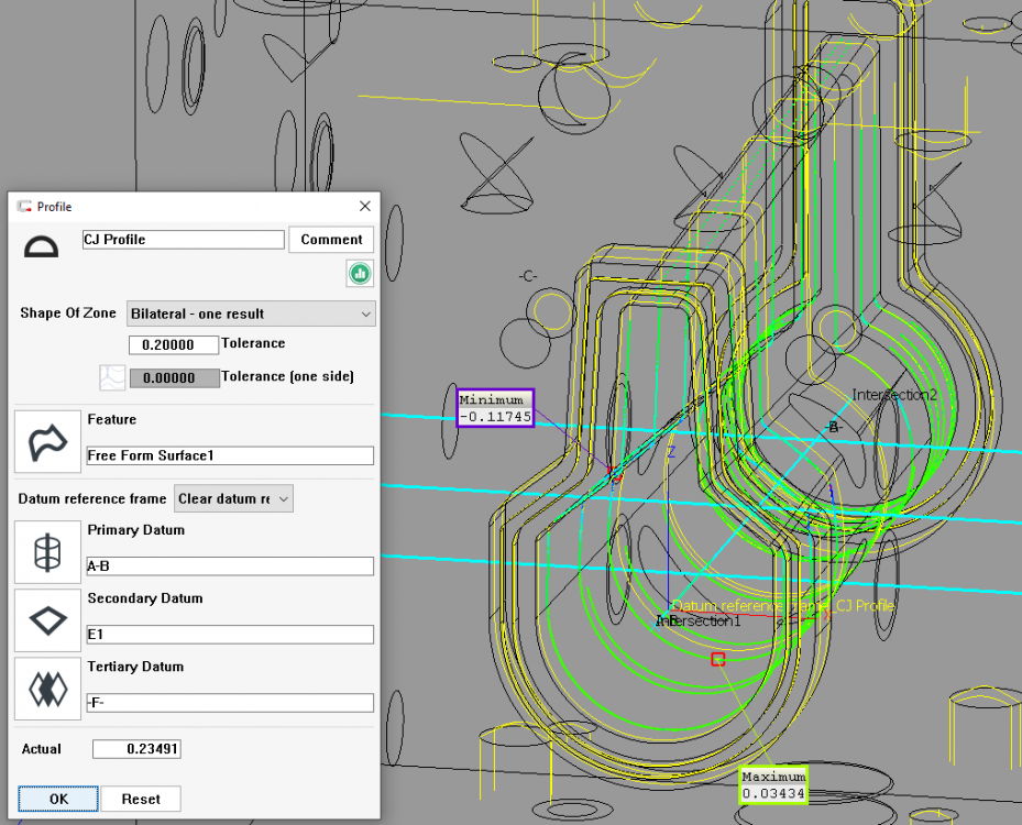

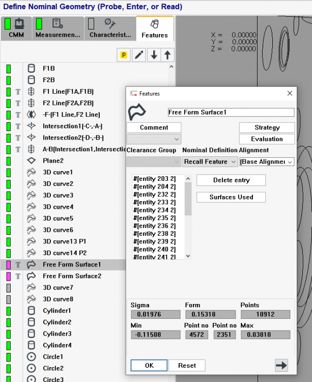

[Da...] Posted March 26, 2025 Share Posted March 26, 2025 I'm running version 7.8.0605 of Calypso and now seem to be having issues with freeform surfaces throwing an error saying "Not enough points available for feature calculation". The freeform feature is built from recalling several 3D curves which have no problems by themselves but Calypso seems to not like freeform surfaces for some reason. There are thousands of points that make up the freeform feature which are more than enough for "feature calculation" and I've done this same thing several times in the past. Is this a bug in the latest version of Calypso or am I missing something? Link to comment https://qualityforum.zeiss.com/topic/22879-freeform-surface-feature-calculation-error/ Share on other sites More sharing options...
[Ri...] Posted March 26, 2025 Share Posted March 26, 2025 Try deleting all of the cad surface associations for the Free-Form, and then selecting the surfaces again. Link to comment https://qualityforum.zeiss.com/topic/22879-freeform-surface-feature-calculation-error/#findComment-129027 Share on other sites More sharing options...
[Da...] Posted March 26, 2025 Author Share Posted March 26, 2025 It still cannot calculate the feature after deleting and re-selecting the surfaces. Link to comment https://qualityforum.zeiss.com/topic/22879-freeform-surface-feature-calculation-error/#findComment-129099 Share on other sites More sharing options...
[Da...] Posted March 26, 2025 Author Share Posted March 26, 2025 I updated Calypso to 7.8.1201 and that seemed to fix the issue. Link to comment https://qualityforum.zeiss.com/topic/22879-freeform-surface-feature-calculation-error/#findComment-129109 Share on other sites More sharing options...
