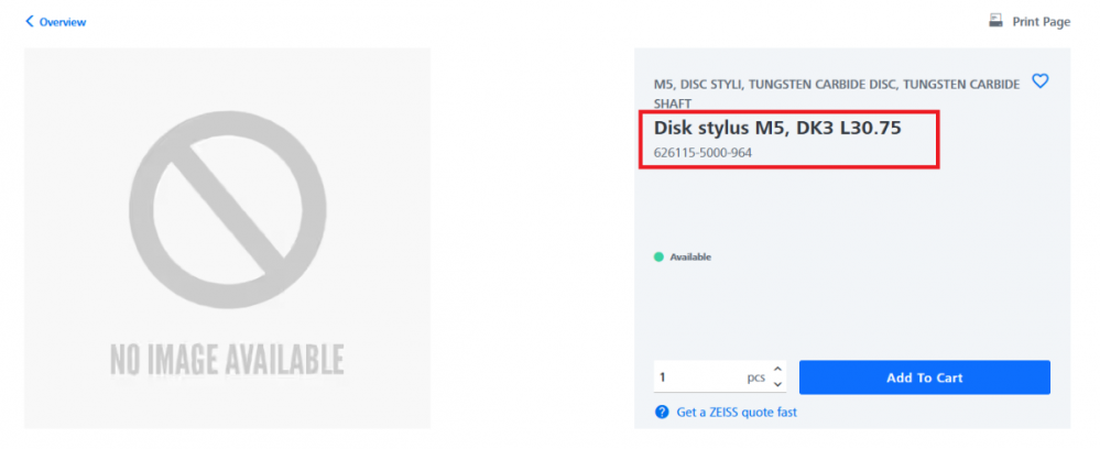

[Ma...] Posted March 31, 2025 Share Posted March 31, 2025 Hi, I can't find disk stylus for the vast xxt head (M3 thread) in the Zeiss store. Do you have experience with using such disks with the vast xxt? Is there an adapter available to go from the M5 disk below to M3? Link to comment https://qualityforum.zeiss.com/topic/22933-disc-stylus-for-vast-xxt-head/ Share on other sites More sharing options...
[Cl...] Posted March 31, 2025 Share Posted March 31, 2025 (edited) Yes, we use such an adapter (M5 to M3), I know they exist; we use them. I don't really have time to look, but they are there. Edited March 31, 2025 Link to comment https://qualityforum.zeiss.com/topic/22933-disc-stylus-for-vast-xxt-head/#findComment-129319 Share on other sites More sharing options...
[Ky...] Posted March 31, 2025 Share Posted March 31, 2025 For reference, a disc stylus is not supported for the VAST XXT. It cannot be qualified properly even if you find a way around it, we cannot guarantee the accuracy. 1 Link to comment https://qualityforum.zeiss.com/topic/22933-disc-stylus-for-vast-xxt-head/#findComment-129321 Share on other sites More sharing options...

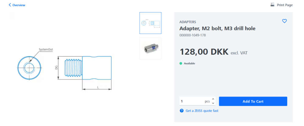

[Ma...] Posted April 8, 2025 Author Share Posted April 8, 2025 Please sign in to view this quote. I'm trying to find an adapter in the Zeiss store like the one below but with M3 bolt, M5 drill hole and I didn't find it: In short, we want to use a plate dedicated to the prismo machine (M5 system, active head) in the Duramax machine with the M3 pin system and the vast xxt head. If you have used such an adapter and have a moment to look for it, I would be grateful for your help Link to comment https://qualityforum.zeiss.com/topic/22933-disc-stylus-for-vast-xxt-head/#findComment-129847 Share on other sites More sharing options...
[A...] Posted April 8, 2025 Share Posted April 8, 2025 I didn't see any on Zeiss but Q•Mark has this on their website. I also found an M2 Disk on Q•Mark and included that as well as the thread adapter as the last 2. • M3 to M5 Thread Adapter | PN: RM3-M5 • M3 to M2 Thread Adapter | PN: RM3XXT-M2 • M2 Disk Probe | PN: DSK-M2-180 Link to comment https://qualityforum.zeiss.com/topic/22933-disc-stylus-for-vast-xxt-head/#findComment-129883 Share on other sites More sharing options...
[Ma...] Posted April 8, 2025 Author Share Posted April 8, 2025 Please sign in to view this quote. Perfect. I found this on Q-Mark. Thanks a lot for your help 🙂 Link to comment https://qualityforum.zeiss.com/topic/22933-disc-stylus-for-vast-xxt-head/#findComment-129889 Share on other sites More sharing options...
