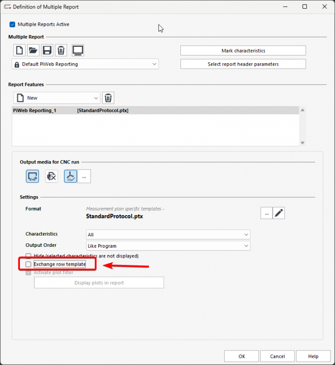

[Ca...] Posted April 2, 2025 Share Posted April 2, 2025 We received a test plan from a customer. It contains a large number of plots in landscape format in the PIWEB report. Does anyone know how I can remove these from the test plan? The numerical values are perfectly sufficient for us. Link to comment https://qualityforum.zeiss.com/topic/22977-remove-plot-from-report/ Share on other sites More sharing options...
[Lu...] Posted April 2, 2025 Share Posted April 2, 2025 Hi Carsten, You most likely can turn off "Exchange row template" to remove the plots. If that doesn't do it, you may have to edit or change the PiWeb reporting template. Link to comment https://qualityforum.zeiss.com/topic/22977-remove-plot-from-report/#findComment-129551 Share on other sites More sharing options...

[Ky...] Posted April 2, 2025 Share Posted April 2, 2025 The end of this document covers how to turn on the plots, but doing the opposite should stop them from showing up in PiWeb (unless they added the plot protocol, in which case, you can delete that from the report features list). https://portal.zeiss.com/knowledge-base?id=443694 Link to comment https://qualityforum.zeiss.com/topic/22977-remove-plot-from-report/#findComment-129565 Share on other sites More sharing options...

[An...] Posted April 3, 2025 Share Posted April 3, 2025 That Knowledge Base is US only. Kyle is referring to this: If the "Exchange Row Template" box is marked, unmark it. Link to comment https://qualityforum.zeiss.com/topic/22977-remove-plot-from-report/#findComment-129655 Share on other sites More sharing options...
