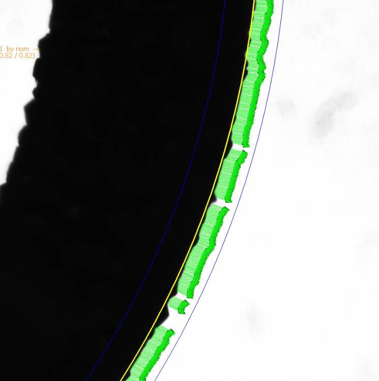

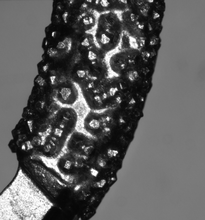

[Si...] Posted April 4 Share Posted April 4 Hello, I'm looking for tips on how to measure the OD and ID of some diamond coated cutting tool. Calypso is filtering out highest points because they are the outliers but I would like to measure the diameter only using the highest points. Does anyone have tips on how I can approach this? Thank you! Link to comment Share on other sites More sharing options...

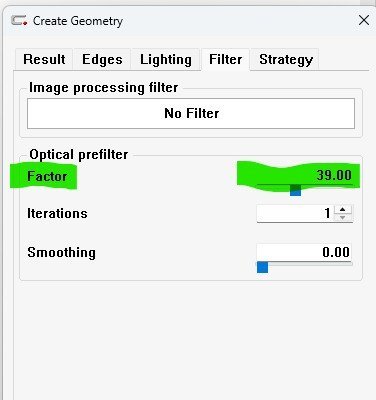

[No...] Posted April 7 Share Posted April 7 (edited) Try lowering the prefilter factor until all the highest points are included: Edited April 7 Link to comment Share on other sites More sharing options...
[Si...] Posted April 10 Author Share Posted April 10 Thank you! I was able to get it to work by lowering the prefilter factor and then using the minimum circumscribed/ maximum inscribed evaluation method for the OD/ ID. Link to comment Share on other sites More sharing options...
