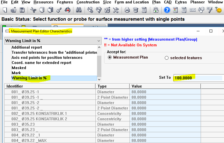

[Mi...] Posted April 7, 2025 Share Posted April 7, 2025 Hello Community, I have trouble finding the Warning thresholds. There has to be a setting somewhere were i can enter a percentage. If the diviation of my dimensions is greater the the percentage of my tolerance it should be colourcoded yellow. It has to be somewhere but i just cant find it.. Thanks for your help! Link to comment https://qualityforum.zeiss.com/topic/23021-where-do-i-find-the-percentage-warning-threshold-settings/ Share on other sites More sharing options...

[Mi...] Posted April 7, 2025 Author Share Posted April 7, 2025 Please sign in to view this quote. Thank you! 🙂 Link to comment https://qualityforum.zeiss.com/topic/23021-where-do-i-find-the-percentage-warning-threshold-settings/#findComment-129785 Share on other sites More sharing options...
