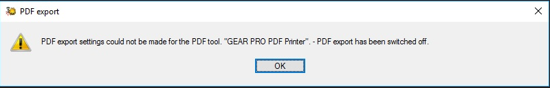

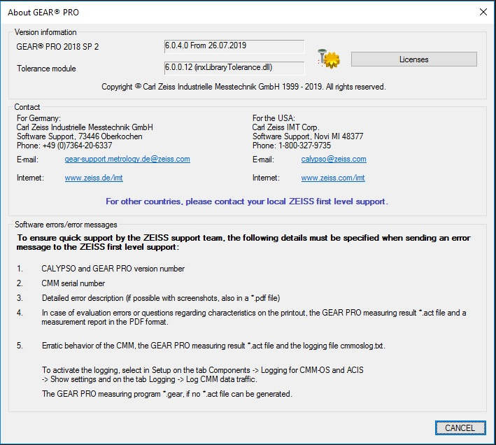

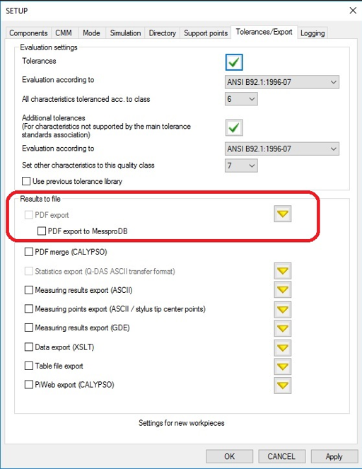

[Jo...] Posted April 7, 2025 Share Posted April 7, 2025 I'm getting a Pop-Up window indicating that PDF export could not be made for the tool "GEAR PRO PDF Printer" - PDF export has been switched off. I'm still using the 2018 version with SP2. It's been working fine before. All of the settings (parameters) for PDF exporting are still there. I checked the settings under the Presentation and the regular Setup. Within the Setup, the Tolerance/Export tab, in the Results to file, the PDF export has been grayed-out. What could have cause this to happened or do I need the GEAR PRO PDF printer's driver installed. And if so, is that a separate download or from the installation. My thought is that this should have been installed already. Yours thoughts and directions for a solution would be greatly appreciated. Thanks. PS. We are planning to upgrade to the latest 2024 version pending Windows 10 upgrade. In the meantime, we hope to resolve this simple issue. Joseph Khang Link to comment https://qualityforum.zeiss.com/topic/23035-gear-pro-pdf-not-exporting/ Share on other sites More sharing options...

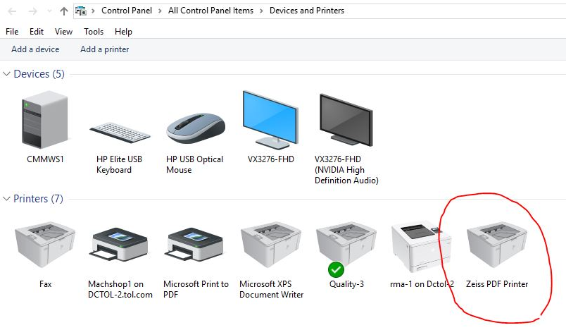

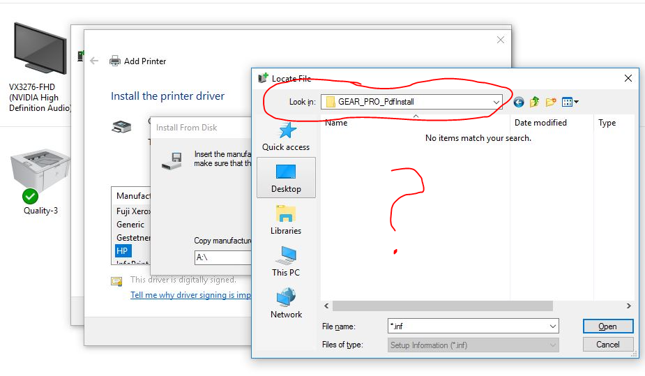

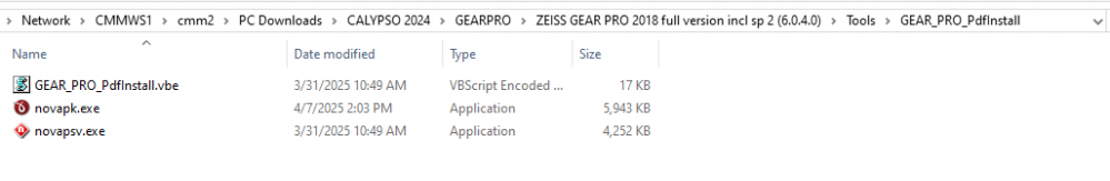

[Jo...] Posted April 7, 2025 Author Share Posted April 7, 2025 I appreciated the feedback. So, I checked the workstation printers and did not see any with "GEAR PRO PDF" printer name. The "Zeiss PDF Printer" is there, just not the gear pro printer. This is all that's in the Tool folder from the download for version 2018. I went ahead and install the 2 bottom exe files but still was not showing on the Device and Printer page either. The 1st file looks like the one but can't install. It's not showing up when I try to search and install it manually from that folder: This is what we have for printers on this Workstation, just the Zeiss PDF Printer: It's missing the Gear Pro PDF printer. Should be a simple process, but I'm just not seeing it. This is a specific Printer and so might need more in-depth help. Let me know what you have or anyone. Link to comment https://qualityforum.zeiss.com/topic/23035-gear-pro-pdf-not-exporting/#findComment-129813 Share on other sites More sharing options...
[Ky...] Posted April 7, 2025 Share Posted April 7, 2025 Doesn't look like the Zeiss PDF Printer7 is there either (yes, the printer7 is different from just the printer). You do have to run that vbe file, if possible, to install the printer. The bottom two files are just drivers and don't actually add the printer. The vbe should have the commands to create the printer. You can try to create it manually if you can't get that to run, but it is a bit of a hassle. If you have an SMA, I would probably just recommend you give us a call to set up a ticket and we will help you out when we are available. Link to comment https://qualityforum.zeiss.com/topic/23035-gear-pro-pdf-not-exporting/#findComment-129815 Share on other sites More sharing options...

[Ro...] Posted April 8, 2025 Share Posted April 8, 2025 Hi, I definetly agree with your last sentence. However a bugfixing for the 2018 version will not happen 😉 Did you already test the last patch version from the ZEISS Portal? GEAR_PRO_2018_6.0.0416_2021.03.23_Patch.zip. Maybe this helps out? Link to comment https://qualityforum.zeiss.com/topic/23035-gear-pro-pdf-not-exporting/#findComment-129839 Share on other sites More sharing options...
