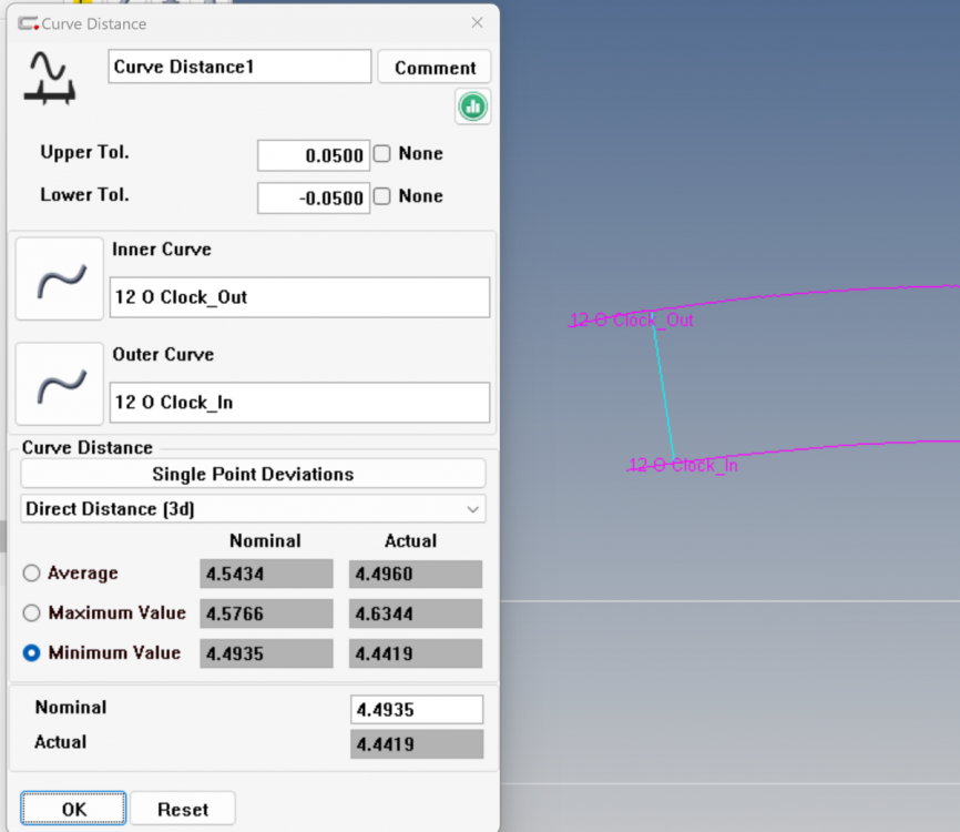

[Jo...] Posted April 7, 2025 Share Posted April 7, 2025 Good morning all, I am looking to see if it is possible to create a line based on the minimum distance between two curves using the "Curve Distance" Characteristic. See the attached image. Have a minimum distance line created in the CAD window. I want to use the line created between the two points to do further calculations. Is this possible? I could not figure out a way to create two points in the same location to simulate how the calculation works in the characteristics. Appreciate the help! Link to comment https://qualityforum.zeiss.com/topic/23041-can-you-create-a-line-from-a-characteristic-evaluation-curve-dist/ Share on other sites More sharing options...
[Cl...] Posted April 7, 2025 Share Posted April 7, 2025 (edited) You should be able to construct a 3d line by using the two points created by a Minimum or Maximum coordinate. pull each curve into a Min & Max coordinate. Using the nominal feature option. Edited April 7, 2025 Link to comment https://qualityforum.zeiss.com/topic/23041-can-you-create-a-line-from-a-characteristic-evaluation-curve-dist/#findComment-129807 Share on other sites More sharing options...
[Jo...] Posted April 7, 2025 Author Share Posted April 7, 2025 Please sign in to view this quote. Hey Clarke, I did try that, but it was just a min/max relative to the coordinate system and not relative to the relationship between the two curves. Link to comment https://qualityforum.zeiss.com/topic/23041-can-you-create-a-line-from-a-characteristic-evaluation-curve-dist/#findComment-129811 Share on other sites More sharing options...
[Cl...] Posted April 8, 2025 Share Posted April 8, 2025 What about opening two-point features and recalling individual opposing curve points into each one from each of the two curves? Then recall those constructed points into a 3d line? Link to comment https://qualityforum.zeiss.com/topic/23041-can-you-create-a-line-from-a-characteristic-evaluation-curve-dist/#findComment-129829 Share on other sites More sharing options...
[Jo...] Posted April 8, 2025 Author Share Posted April 8, 2025 Morning Clarke, I understand what you mean, but the software doesn't provide any insight into the points being used for this curve distance evaluation. I tried a formula to see what I could extract from the curve distance characteristic, but it only gives me the option to select XYZ and actual. I am starting to believe it's not possible. Link to comment https://qualityforum.zeiss.com/topic/23041-can-you-create-a-line-from-a-characteristic-evaluation-curve-dist/#findComment-129833 Share on other sites More sharing options...

[Ha...] Posted April 11, 2025 Share Posted April 11, 2025 Could you try recalling a specific curve point, e.g. point 150, check the box for Curve result points (Filtered,...), then recall the two points into a 3D line? Link to comment https://qualityforum.zeiss.com/topic/23041-can-you-create-a-line-from-a-characteristic-evaluation-curve-dist/#findComment-130167 Share on other sites More sharing options...
[Jo...] Posted April 14, 2025 Author Share Posted April 14, 2025 Please sign in to view this quote. I thought about this as well. The only problem is that the evaluation doesn't give me the point # to try this. Link to comment https://qualityforum.zeiss.com/topic/23041-can-you-create-a-line-from-a-characteristic-evaluation-curve-dist/#findComment-130295 Share on other sites More sharing options...

[Ma...] Posted April 22, 2025 Share Posted April 22, 2025 I have to admit, that i did not fully gained both points - perhaps wrong curves - but i've made two copies of distance of curve, where i swapped features ( curve_distance_1: 1c / 2c || curve_distance_2: 2c / 1c ) and set both on same ( min/min || max/max ) - then you can use formula to obtain X,Y,Z for a point ( using curve_distance_1 and 2 to get 3d line ) I don't know what author needs. Link to comment https://qualityforum.zeiss.com/topic/23041-can-you-create-a-line-from-a-characteristic-evaluation-curve-dist/#findComment-130753 Share on other sites More sharing options...
