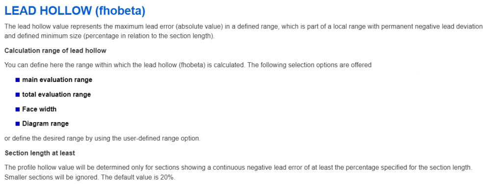

[To...] Posted April 9, 2025 Share Posted April 9, 2025 Does the latest version of GearPro have the ability to measure percentage of concavity or hollow in a crowned lead? Asking for a friend. Link to comment https://qualityforum.zeiss.com/topic/23067-measure-percentage-of-concavity-or-hollow-in-a-crowned-lead/ Share on other sites More sharing options...

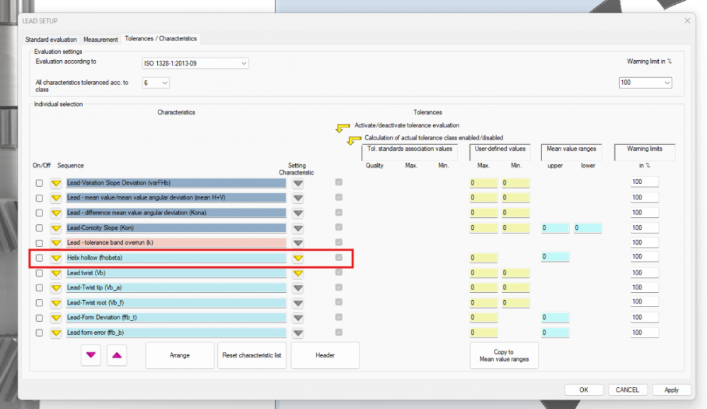

[Ky...] Posted April 9, 2025 Share Posted April 9, 2025 There is a characteristic called "Helix Hollow" (specifically it is f_hoß, or at least I think that's what it's saying). I actually think its been there at least since 2018 (since I started using Gear Pro regularly), though I'm not 100% sure it is what you are looking for. Hopefully Roman sees this tomorrow and can weigh in a bit. I understand the mor normal characteristics, but some of these specialized things (like twist and hollow) I'm not nearly as familiar with. Link to comment https://qualityforum.zeiss.com/topic/23067-measure-percentage-of-concavity-or-hollow-in-a-crowned-lead/#findComment-129961 Share on other sites More sharing options...

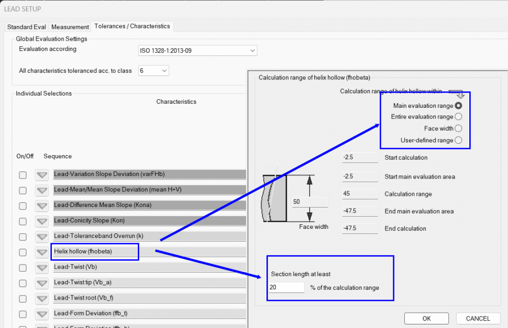

[Ro...] Posted April 10, 2025 Share Posted April 10, 2025 Evaluation of hollow is possible, yes. Settings can be done as follows: Description of the functionality you can find in the user manual or by pushing the F1 Button in the dialog: Is this what you are asking for? Link to comment https://qualityforum.zeiss.com/topic/23067-measure-percentage-of-concavity-or-hollow-in-a-crowned-lead/#findComment-129975 Share on other sites More sharing options...
[To...] Posted April 10, 2025 Author Share Posted April 10, 2025 Please sign in to view this quote. Thank you for this information. I believe this what my friend was looking for but I will update this post if more info is needed. Again, thank you. Link to comment https://qualityforum.zeiss.com/topic/23067-measure-percentage-of-concavity-or-hollow-in-a-crowned-lead/#findComment-130003 Share on other sites More sharing options...
