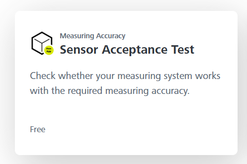

[Mi...] Posted April 10, 2025 Share Posted April 10, 2025 We want to run Acceptance Tests using the GOM Probing/Spacing Artifact 400 , carbon plates with steel spheres to test diameter and distance made by DYNAMIC(?) The GOM Inspect help shows a script being used to run the tests with drop down menus for which lens set is being evaluated. I did a search on the local machine for the python script with no luck. Link to comment https://qualityforum.zeiss.com/topic/23087-acceptance-test-is-the-gat-10360-8-script-pre-installed/ Share on other sites More sharing options...
[Ax...] Posted April 11, 2025 Share Posted April 11, 2025 First, you need to create a template. To do this, you need the script, which you can install as an add-on. Only then can you perform the verification with the template. Link to comment https://qualityforum.zeiss.com/topic/23087-acceptance-test-is-the-gat-10360-8-script-pre-installed/#findComment-130127 Share on other sites More sharing options...
[Qu...] Posted April 11, 2025 Share Posted April 11, 2025 Hi Axel, Do you have a step-by-step for running this in the latest software? I have successfully set up both templates and master templates, and run the 3 tests using the 'expert' drop down to run the calibration and 3 positions in one, but have not had success in evaluating once data is collected. Is there a script that polygonizes and runs the evaluation? I can only see an 'export evaluation script. All of the manuals refer to analysis on software pre-'part-project'. Perhaps Mike will get further than I did but a step-by-step would be useful. Link to comment https://qualityforum.zeiss.com/topic/23087-acceptance-test-is-the-gat-10360-8-script-pre-installed/#findComment-130159 Share on other sites More sharing options...
[Ax...] Posted April 16, 2025 Share Posted April 16, 2025 Only in German. Maybe, you can find it @downloads Link to comment https://qualityforum.zeiss.com/topic/23087-acceptance-test-is-the-gat-10360-8-script-pre-installed/#findComment-130453 Share on other sites More sharing options...
[Ky...] Posted April 16, 2025 Share Posted April 16, 2025 Hi Quintus, Axel is Correct the script can be located in the software store. you can find this on page 12 in the software store. as for a step by step by step guide. one is normally provided with the Training class that Zeiss hosts for VDI's if you are interested in that class i would reach out to your sales rep or to your support provider. Link to comment https://qualityforum.zeiss.com/topic/23087-acceptance-test-is-the-gat-10360-8-script-pre-installed/#findComment-130471 Share on other sites More sharing options...
