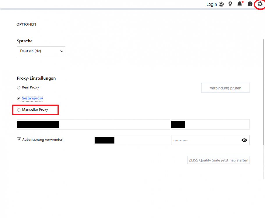

[Ri...] Posted May 26, 2021 Share Posted May 26, 2021 The option for logging in comes up however when I press login, nothing happens. Without logging in, I can't use this software at all. Link to comment https://qualityforum.zeiss.com/topic/231-gom-inspect-suite-will-not-let-me-login/ Share on other sites More sharing options...

[88...] Posted May 27, 2021 Share Posted May 27, 2021 Hi! The "Login" button in the GOM Inspect Suite would simply launch the GOM Software Center, which will handle the login. If that cannot be launched, it would show an error. So I assume it is in fact started, but crashes, therefore nothing seems to happen. Make sure to use the latest 2020 Hotfix to avoid problems. If the problems remain, please create a GOMSIC using the Maintenance tool and send it to support@gom.com. Regards, Kai Fontein Link to comment https://qualityforum.zeiss.com/topic/231-gom-inspect-suite-will-not-let-me-login/#findComment-652 Share on other sites More sharing options...
[La...] Posted January 12, 2023 Share Posted January 12, 2023 Login does not work in the GOM Software Center. When I press the login in there, something blinks, but nothing where you could do the login opens. And it is not hidden behind other windows either. Login on browser works just fine, but that does not help me with GOM Inspect. I am running on Windows 10 on Dell 7670. Link to comment https://qualityforum.zeiss.com/topic/231-gom-inspect-suite-will-not-let-me-login/#findComment-5694 Share on other sites More sharing options...
[La...] Posted January 12, 2023 Share Posted January 12, 2023 Please sign in to view this quote. Un-installing and re-installing did not help either. I can log in on the lab PC (which is connected to the Atos Q), no problem. That has the same version of the ZEISS quality suite (4.2.1334.0) and quality suite server (4.0.1305.0) Link to comment https://qualityforum.zeiss.com/topic/231-gom-inspect-suite-will-not-let-me-login/#findComment-5698 Share on other sites More sharing options...
[Fa...] Posted January 18, 2023 Share Posted January 18, 2023 Hello Rishab, I think you must change the proxy ideas. Your proxy settings are blocking the lock in. Link to comment https://qualityforum.zeiss.com/topic/231-gom-inspect-suite-will-not-let-me-login/#findComment-6556 Share on other sites More sharing options...
[Mi...] Posted January 24, 2023 Share Posted January 24, 2023 I had an issue like this..... I started Zeiss Quality Software and went to the Log In page. I then started a Browser (Chrome in my case) and headed over to My GOM. I logged in here.... I returned to Zeiss Quality Software and logged in (clicking remember me) and that seemed to work.... Give it a try, it worked for me! Link to comment https://qualityforum.zeiss.com/topic/231-gom-inspect-suite-will-not-let-me-login/#findComment-6638 Share on other sites More sharing options...
