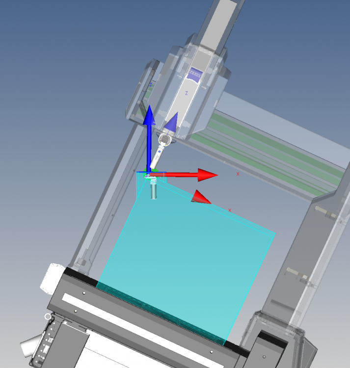

[Di...] Posted April 11, 2025 Share Posted April 11, 2025 When I open the simulator in this program the everything is crooked. It is just this program. Also the geometry on the model is all straight. I wasn't sure if I hit something by accident. I can also save this model from this program and use it to start a new measurement plan and it is straight in the sim. Link to comment https://qualityforum.zeiss.com/topic/23117-part-is-crooked-in-simulator/ Share on other sites More sharing options...

[Di...] Posted April 14, 2025 Author Share Posted April 14, 2025 (edited) It looked good until I went to run it. Then it looked angry again, haha. Edited April 14, 2025 Link to comment https://qualityforum.zeiss.com/topic/23117-part-is-crooked-in-simulator/#findComment-130243 Share on other sites More sharing options...

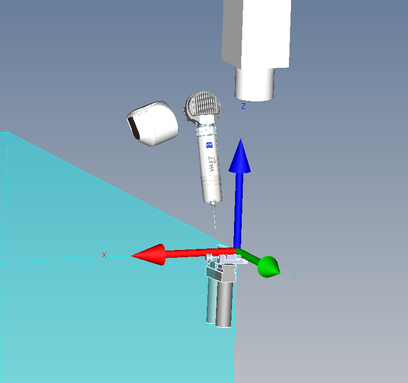

[To...] Posted April 14, 2025 Share Posted April 14, 2025 (edited) Please sign in to view this quote. Can you post a screen cap of your base alignment window?? Then, screen cap of the feature used for your planar rotation? Edited April 14, 2025 Link to comment https://qualityforum.zeiss.com/topic/23117-part-is-crooked-in-simulator/#findComment-130269 Share on other sites More sharing options...
[Di...] Posted April 14, 2025 Author Share Posted April 14, 2025 Its 3d best fit Alignment. there is nothing straight Link to comment https://qualityforum.zeiss.com/topic/23117-part-is-crooked-in-simulator/#findComment-130275 Share on other sites More sharing options...
[Di...] Posted April 14, 2025 Author Share Posted April 14, 2025 (edited) Edited April 14, 2025 Link to comment https://qualityforum.zeiss.com/topic/23117-part-is-crooked-in-simulator/#findComment-130279 Share on other sites More sharing options...
[Di...] Posted April 14, 2025 Author Share Posted April 14, 2025 Now it works perfectly. Link to comment https://qualityforum.zeiss.com/topic/23117-part-is-crooked-in-simulator/#findComment-130283 Share on other sites More sharing options...
