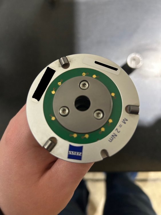

[Lu...] Posted April 14, 2025 Share Posted April 14, 2025 Hello, should I be cleaning this surface? If so, then with what? (I know the answer is almost definitely yes, so I apologize for asking such an obvious question, I just don't have anyone to ask where I work at and don't want to mess anything up. From what I know, currently nobody cleans this surface or many parts of this CMM so I am trying to learn any maintenance I should be doing, thank you!) Link to comment https://qualityforum.zeiss.com/topic/23135-quick-cleaning-question/ Share on other sites More sharing options...
[To...] Posted April 14, 2025 Share Posted April 14, 2025 Alcohol on the 3 pins at a minimum. Wipe the whole thing down is fine. Link to comment https://qualityforum.zeiss.com/topic/23135-quick-cleaning-question/#findComment-130271 Share on other sites More sharing options...

[No...] Posted April 15, 2025 Share Posted April 15, 2025 The upper two golden contacts with the small dark dots MAY need some cleaning in the future if you ever get errors indicating the plate isn't recognized properly. Alcohol alone probably won't do then. Such contacts are best gently cleaned with a glass fibre contact cleaner. But as long as you don't get any errors, better don't touch them. Link to comment https://qualityforum.zeiss.com/topic/23135-quick-cleaning-question/#findComment-130327 Share on other sites More sharing options...
