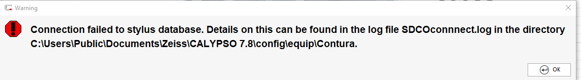

[Du...] Posted April 14, 2025 Share Posted April 14, 2025 (edited) can anyone explain what is happening here, was working fine right before lunch edit: nevermind, a restart of the pc fixed the issue. Edited April 14, 2025 fixed issue Link to comment https://qualityforum.zeiss.com/topic/23143-connection-failed-to-stylus-database/ Share on other sites More sharing options...
[Ab...] Posted April 14, 2025 Share Posted April 14, 2025 https://portal.zeiss.com/knowledge-base?id=672139 Link to comment https://qualityforum.zeiss.com/topic/23143-connection-failed-to-stylus-database/#findComment-130299 Share on other sites More sharing options...
[Ky...] Posted April 14, 2025 Share Posted April 14, 2025 As an addendum to the article Abbas listed above, please go into the services and make sure the SQL Server(SDCO) is set to "Automatic" start-up and not "Automatic (Delayed Start)". Link to comment https://qualityforum.zeiss.com/topic/23143-connection-failed-to-stylus-database/#findComment-130309 Share on other sites More sharing options...
