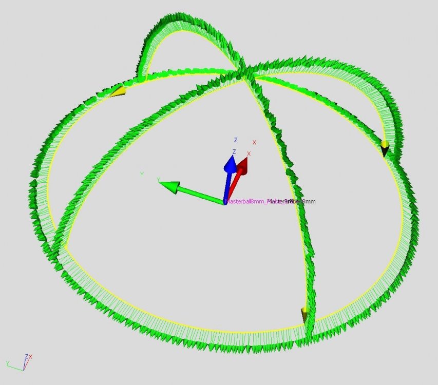

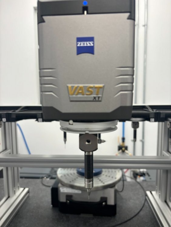

[Er...] Posted April 15, 2025 Share Posted April 15, 2025 Hi all, I am doing a probe verification with DK 0.2mm x MLE 3mm probe and I am getting a 0.001365 mm difference between the diameter of my probe verification's actual (7.99805 mm) and my master sphere's diameter (7.99994 mm). I'm typically used to seeing a difference of 0.000105 mm, which is 10x smaller. Does anyone have an idea on how to do a better qualification and reduce the difference between the probe verification's actual and master sphere's actual diameter? More info on the qualification: Probe: DK 0.2mm x MLE 3mm (626103-5144-018) Probing force = 15mN Probing Dynamic = 5% VAST XT Gold head See Stylus System setup in attached picture More info on the verification: Scan speed = 1 mm/s Number of points per section = 300 points See scan path in attached picture Thank you! Link to comment https://qualityforum.zeiss.com/topic/23153-probe-verification-value-discrepancy/ Share on other sites More sharing options...
[Da...] Posted April 16, 2025 Share Posted April 16, 2025 The tensor calibration of a VAST XT wants to find the best compromise for the probe diameter for different speeds, diameter ranges, and probing forces, depending on the bending parameters of your probe. With very small or not very stiff (or both) probe setups, it will come to its limits. In this case, it is much better to do a six-point-calibration, which disregards the tensor (if you never used the tensor calibration for this probe or deleted the tensor data) or builds up on the existing tensor values. In any case you have to verify, that after the six-point-calibration your probe still measures good by scanning a gauge ring with a known value, and if it doesn’t, you can optimize your probe system using the gauge optimization. You are then somewhat limited to the speed and diameter range you used for the optimization, but at least you can use the probe. Link to comment https://qualityforum.zeiss.com/topic/23153-probe-verification-value-discrepancy/#findComment-130447 Share on other sites More sharing options...
