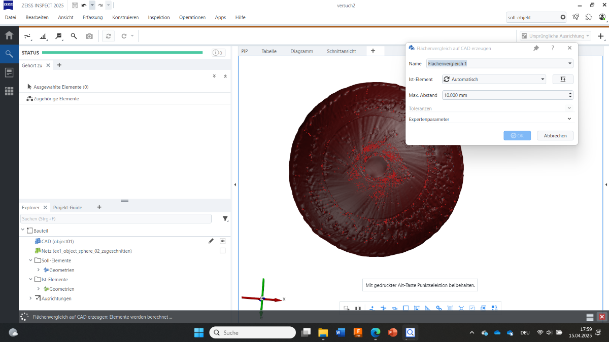

[Le...] Posted April 15, 2025 Share Posted April 15, 2025 Hello everyone, I am trying to compare a CAD and a mesh file. I am following the tutorial I found online: How to Perform Simple Inspections in ZEISS INSPECT Optical 3D (3/5) Yet this does not seem to work for me. It seems as though the system hasnt understood that my Cad is my model how its supposed to be (soll) and my mesh is the current state (ist). When i try to use my first alignment anyway my laptop keeps loading and the page looks like in the picture I attached below but nothing happens and my laptop becomes very very hot. I have no more ideas what I can do or what my mistake is so please, if someone could help me I would be very very grateful!!! Kind regards, Leo Link to comment https://qualityforum.zeiss.com/topic/23157-issues-with-a-simple-inspection/ Share on other sites More sharing options...
[Na...] Posted April 16, 2025 Share Posted April 16, 2025 Hi Leonie, if the mesh is aligned already in the state of this screenshot, please try unlclicking the button next to "Ist-Element Automastisch". It will invert the surface direction so the comparison might not work or won't find points to compare. Lowering the search distance might help too - but this depends on the expected distance. If the prealignment does not work, you can switch to a manual alignment method, like 3-Point-Alignment for example. Nanno Link to comment https://qualityforum.zeiss.com/topic/23157-issues-with-a-simple-inspection/#findComment-130445 Share on other sites More sharing options...

[No...] Posted May 13, 2025 Share Posted May 13, 2025 Judging by your screenshot the program is currently trying to calculate a surface somparison. These can be very time consuming depending on how fast your laptop is. In fact surface comparisons are THE most lengthy calculations in my daily work. How long have you waited for it to complete? If that is not your problem, a more detailed description of all the steps you performed, starting from the blank new project, would give us a better insight into to what possibly went wrong. Link to comment https://qualityforum.zeiss.com/topic/23157-issues-with-a-simple-inspection/#findComment-132063 Share on other sites More sharing options...
