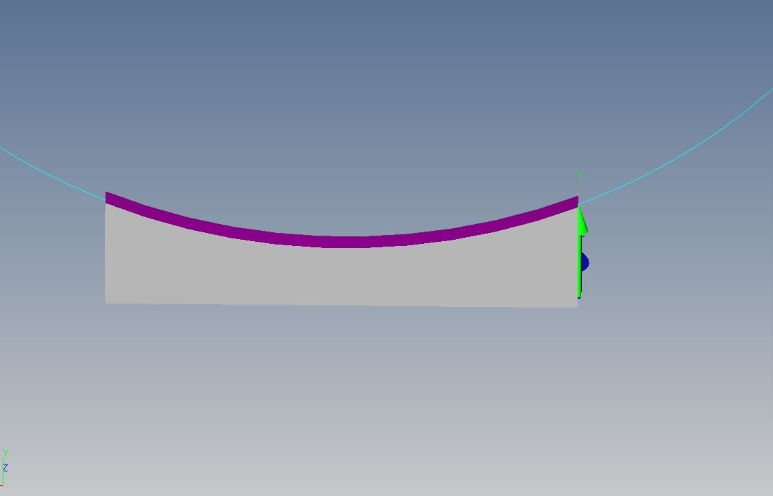

[AG...] Posted April 16, 2025 Share Posted April 16, 2025 The Diameter is 38.038", i am checking it at the Radius, the length of the block is 11.000". As you can see its just a small area of the whole callout. I am looking for some filtering for this particularly crazy area to get the correct dimension. My dimensions are all over the place just looking for some advice. I have messed with speeds and and points and scans i am just not convinced/comfortable of the output the CMM is giving me. If there is any advice it would be greatly appreciated. The engineers have already told me that CMM's don't give good Diameter/Radius readings. I have never had problems in my career with diameters but they seem to think so. Link to comment https://qualityforum.zeiss.com/topic/23183-filters-for-diameter-suggestions/ Share on other sites More sharing options...
[Ma...] Posted April 16, 2025 Share Posted April 16, 2025 Since it's small area, then you will always get unstable results. Much better way would be surface profile callout. You will see those tiny deviations which will result into unstable measurement. 1 Link to comment https://qualityforum.zeiss.com/topic/23183-filters-for-diameter-suggestions/#findComment-130515 Share on other sites More sharing options...
[DW...] Posted April 16, 2025 Share Posted April 16, 2025 Please sign in to view this quote. Please sign in to view this username. Large diameters from small features are inherently unstable. My recommendation is switch to single points (4-6) and constrain the location in the appropriate axes (for example X and Y). Link to comment https://qualityforum.zeiss.com/topic/23183-filters-for-diameter-suggestions/#findComment-130519 Share on other sites More sharing options...
[RP...] Posted April 16, 2025 Share Posted April 16, 2025 With large incomplete radii like this, my go-to method is constraining a radius and recalling the points to another circle feature. Then constraining the location of the recalled feature. Link to comment https://qualityforum.zeiss.com/topic/23183-filters-for-diameter-suggestions/#findComment-130527 Share on other sites More sharing options...

[To...] Posted April 17, 2025 Share Posted April 17, 2025 (edited) Question to the group. If you measure a short arc segment and the form results are very, very low, but the radius is off, which value is more important? Just to add, when the location is constrained, the form gets worse. Edited April 17, 2025 Link to comment https://qualityforum.zeiss.com/topic/23183-filters-for-diameter-suggestions/#findComment-130567 Share on other sites More sharing options...
[Ma...] Posted April 17, 2025 Share Posted April 17, 2025 Please sign in to view this quote. Tom, I think the answer would depend on what information you are looking to obtain from the measurement. If you are trying to find the best approximation of the actual radius then the result with minimum form is best. If you are measuring for compliance to a specific radius tolerance then evaluating the radius values of the points to the constrained location obtained from the constrained radius would be the best. Link to comment https://qualityforum.zeiss.com/topic/23183-filters-for-diameter-suggestions/#findComment-130583 Share on other sites More sharing options...
[Ow...] Posted April 17, 2025 Share Posted April 17, 2025 Attached is simple power point with video's (click on illustration to show start button) I created several years ago for internal beginners training. It seems like last time I shared it there was some devils advocate comments on it but, it is what it is and helps some understand how and why small arcs of circles/radius's measurements can be challenging Small Radius limitiations on a CMM.pptx 1 Link to comment https://qualityforum.zeiss.com/topic/23183-filters-for-diameter-suggestions/#findComment-130589 Share on other sites More sharing options...
[Ma...] Posted April 17, 2025 Share Posted April 17, 2025 If you constrain location, then you are defining radius value within a few 0.0x mm. Bad thing is that unconstrained radius will have form in 0.00x mm and constrained in 0.0x mm - which is debatable. Whenever i am dealing with this i often take into consideration how it is machined and what can go wrong which can result in bad machining, Link to comment https://qualityforum.zeiss.com/topic/23183-filters-for-diameter-suggestions/#findComment-130593 Share on other sites More sharing options...
[AG...] Posted April 17, 2025 Author Share Posted April 17, 2025 I really appreciate all the responses to my question. I ended up after finding that scanning the Radius wasn't repeating i then took points over the majority of the radius and constraining like was suggested to me. This worked out better and more repeatable. Yes like Tom is saying when i constrained the radius the form got worse but my numbers were more repeatable. This helped a lot, thank you. Link to comment https://qualityforum.zeiss.com/topic/23183-filters-for-diameter-suggestions/#findComment-130597 Share on other sites More sharing options...

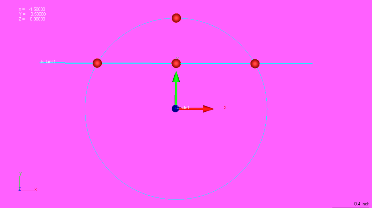

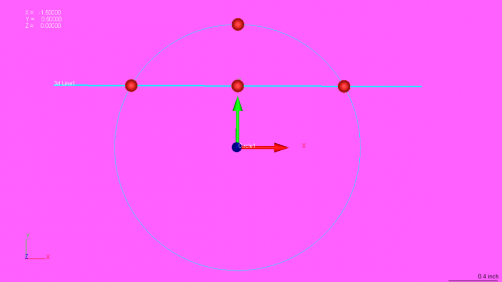

[Cl...] Posted April 18, 2025 Share Posted April 18, 2025 (edited) For what it's worth. I was shown this 25 years ago. It's a simple, quick sanity check. You can either use a theoretical line for the construction or construct intersections if the geometry allows/dictates. In the case of the latter scan/probe the radius and the two lines Intersect each line with the radius. Construct a mid-point from the two intersections. Create a secondary alignment using that mid-point (XY origin). Now probe a point on the radius face at X zero. Translate that point -Y by the nominal radius. Switch to polar coordinates and probe points on the radius. This will best show the actual radius. Edited April 18, 2025 Link to comment https://qualityforum.zeiss.com/topic/23183-filters-for-diameter-suggestions/#findComment-130619 Share on other sites More sharing options...
