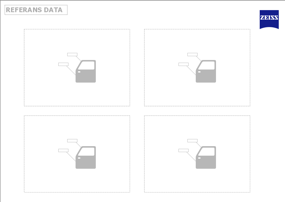

[Üm...] Posted April 16, 2025 Share Posted April 16, 2025 Hello there. In Zeiss inspect 2023 report editing, I want a report output like the picture I sent. In these 4 boxes, I want to add front view, top view, side view and isometric view respectively. Is there an easy method for th is? Can you help me. Link to comment https://qualityforum.zeiss.com/topic/23189-zeiss-inspect-2023-report-page-edit/ Share on other sites More sharing options...
[Ky...] Posted May 2, 2025 Share Posted May 2, 2025 Hi Umit, you should be able to snip or capture these views from the report page work space, if not i would import them as images. i have included 2 links that may help with what your asking. https://techguide.zeiss.com/en/zeiss-inspect-2025/article/general_manage_report_style.html https://techguide.zeiss.com/en/zeiss-inspect-2025/article/cmd_report_overwrite_report_template.html Link to comment https://qualityforum.zeiss.com/topic/23189-zeiss-inspect-2023-report-page-edit/#findComment-131433 Share on other sites More sharing options...
[Üm...] Posted June 30, 2025 Author Share Posted June 30, 2025 Oh, hello there. Kyle. Would it be possible for you to explain with a screenshot about this? Thank you for your reply. Link to comment https://qualityforum.zeiss.com/topic/23189-zeiss-inspect-2023-report-page-edit/#findComment-134479 Share on other sites More sharing options...
