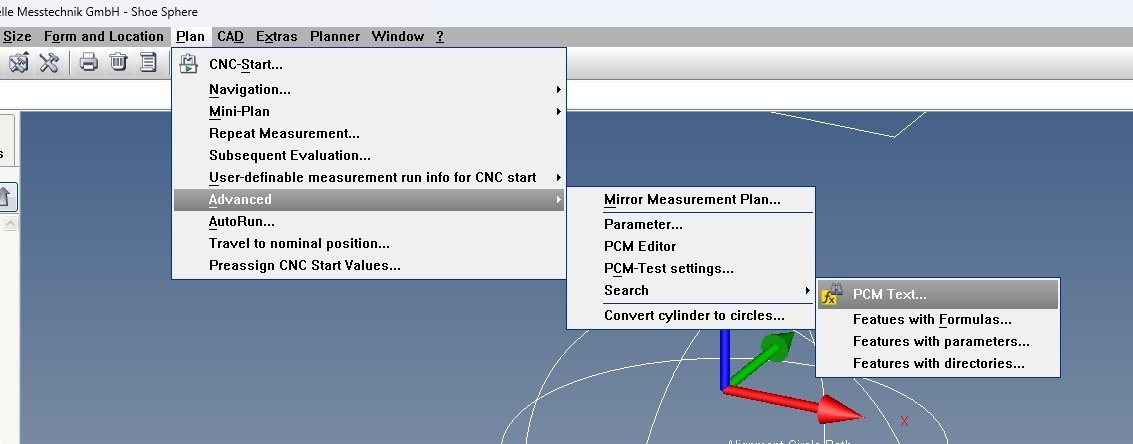

[Ca...] Posted April 19, 2025 Share Posted April 19, 2025 I received a program from our customer with a large number of integrated PCM commands. Now I need to adapt some variable names and path names to our system. Is there a way to easily find all PCM commands in the test plan? Otherwise, do I have to check each individual element? Link to comment Share on other sites More sharing options...
[Ri...] Posted April 19, 2025 Share Posted April 19, 2025 Try either one of the options shown in the menus. Link to comment Share on other sites More sharing options...
[Ma...] Posted April 19, 2025 Share Posted April 19, 2025 This could also be helpful: https://qualityforum.zeiss.com/topic/23017-export-all-the-pcm-in-measurement-plan Link to comment Share on other sites More sharing options...
