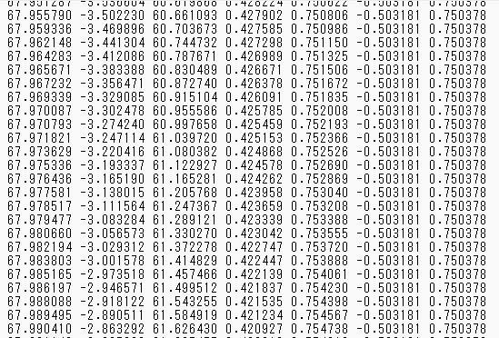

[WM...] Posted April 29, 2025 Author Share Posted April 29, 2025 Thanks Roman However, I understand that XSLT can only output the stylus center points, the ideal vector, and the stylus radius. For example, the image below shows the output values for the break edge, but the Z-direction vector is consistently -0.503181. If this ideal vector is used directly in the chart output, I believe there will be a discrepancy between the gear generated by GearPro and the actual shape, leading to measurement errors. Therefore, I am curious about how GearPro measures the tooth profile and tooth trace, and what processing it performs to output the chart. I thought that the surface points of the workpiece were calculated using the stylus center points,stylus radius and the actual vector, but if I am wrong, could you please provide an overview of the logic used to output the chart? (My next guess is that Morphological profile filters is used for contraction processing.) I apologize for asking so many questions, but I appreciate your help. Link to comment https://qualityforum.zeiss.com/topic/23219-actual-vector/#findComment-131115 Share on other sites More sharing options...

[Ro...] Posted April 30, 2025 Share Posted April 30, 2025 This is how the software calculates the deviations. It is not possible to export the actual normal vectors. Just the nominal normal vectors incl. the deviations as follows: Link to comment https://qualityforum.zeiss.com/topic/23219-actual-vector/#findComment-131183 Share on other sites More sharing options...
