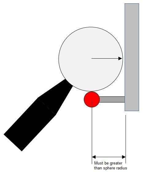

[Ol...] Posted April 23, 2025 Share Posted April 23, 2025 During probe qualification at one position the carbon fibre shaft collides with the sphere. How to avoid this collision? at other position calibration is sucessfull Thank you. Link to comment https://qualityforum.zeiss.com/topic/23225-l-shape-probe-qualification-error/ Share on other sites More sharing options...
[Ma...] Posted April 23, 2025 Share Posted April 23, 2025 I would say using smaller sphere. Depending on usage of such probe and head would help reducing coverage angle of a sphere. 1 Link to comment https://qualityforum.zeiss.com/topic/23225-l-shape-probe-qualification-error/#findComment-130785 Share on other sites More sharing options...
[Cl...] Posted April 23, 2025 Share Posted April 23, 2025 (edited) Is the carbon fiber shaft length less than the ref sphere radius? Edited April 23, 2025 Link to comment https://qualityforum.zeiss.com/topic/23225-l-shape-probe-qualification-error/#findComment-130789 Share on other sites More sharing options...
[Ma...] Posted April 29, 2025 Share Posted April 29, 2025 What angle are you qualifying at? 15 degrees? 90? Link to comment https://qualityforum.zeiss.com/topic/23225-l-shape-probe-qualification-error/#findComment-131173 Share on other sites More sharing options...
[Ke...] Posted April 30, 2025 Share Posted April 30, 2025 XT or XXT or? Link to comment https://qualityforum.zeiss.com/topic/23225-l-shape-probe-qualification-error/#findComment-131187 Share on other sites More sharing options...
[To...] Posted April 30, 2025 Share Posted April 30, 2025 (edited) Relative to Martin's and Clarke's response. A smaller reference sphere is usually the solution, i.e. 8mm, 10mm. I say 8 or 10 because it may come in handy for smaller probes or probe configs. Or, an extension between the stylus and the vertical shaft. Edited April 30, 2025 Link to comment https://qualityforum.zeiss.com/topic/23225-l-shape-probe-qualification-error/#findComment-131191 Share on other sites More sharing options...
