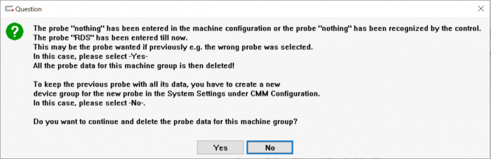

[Ra...] Posted April 23, 2025 Share Posted April 23, 2025 (edited) We recently just replaced the speed knob. Powered down the machine, disconnected the wire on the control box and replaced the knob with a new one. When I powered up the machine and the software , we are getting the following error. Edited April 23, 2025 Link to comment https://qualityforum.zeiss.com/topic/23233-need-help-replaced-speed-knob/ Share on other sites More sharing options...
[Ra...] Posted April 23, 2025 Author Share Posted April 23, 2025 We have a vast xxt head and a viscan. I left the viscan on , when i powered down and replaced. Link to comment https://qualityforum.zeiss.com/topic/23233-need-help-replaced-speed-knob/#findComment-130827 Share on other sites More sharing options...

[Ra...] Posted April 24, 2025 Author Share Posted April 24, 2025 I had to turn camera mode off in calypso. Then restart the software. Its back up. :) Link to comment https://qualityforum.zeiss.com/topic/23233-need-help-replaced-speed-knob/#findComment-130863 Share on other sites More sharing options...
