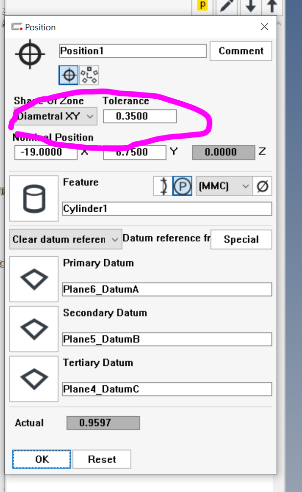

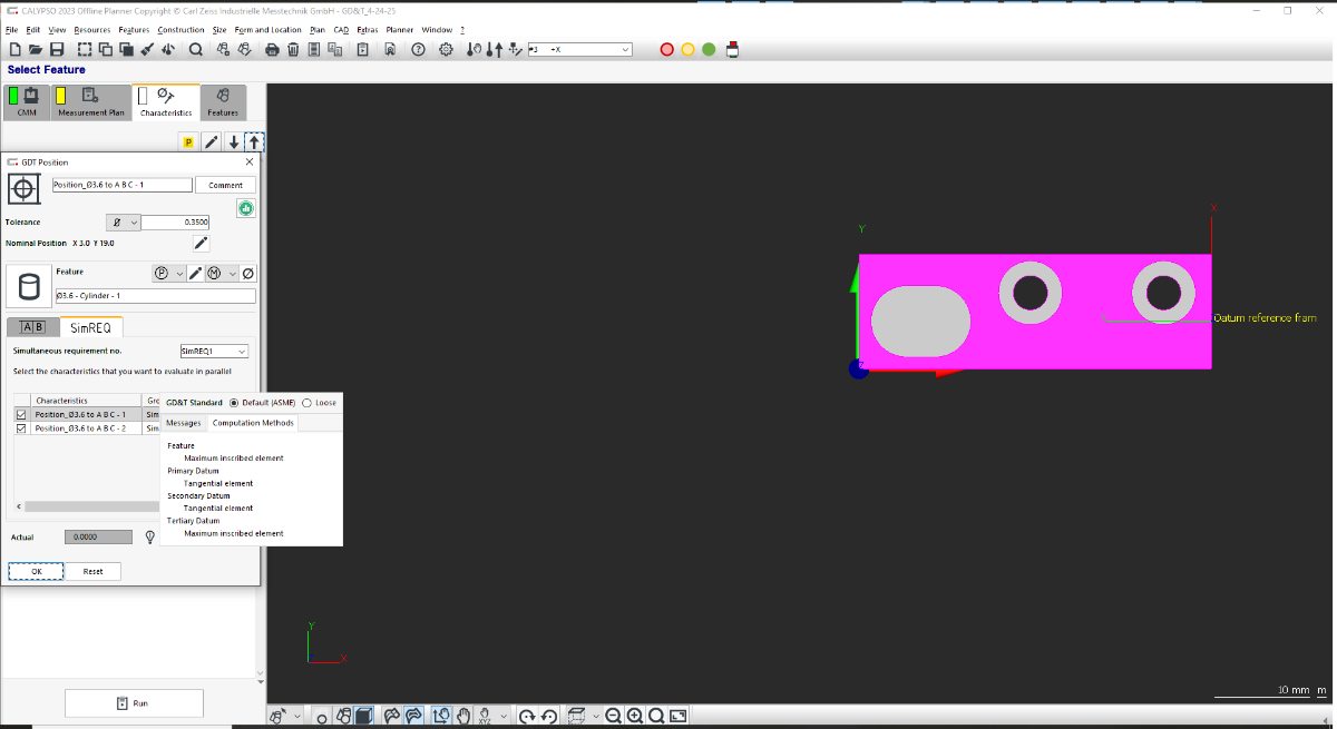

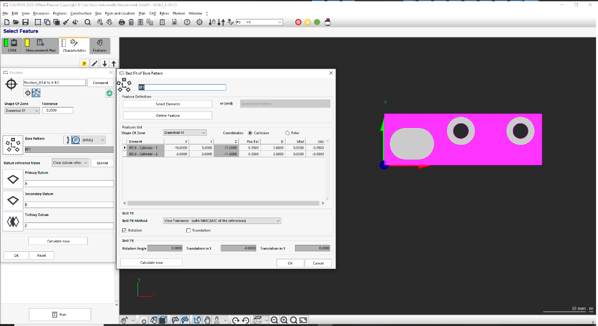

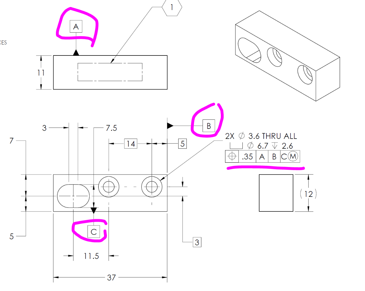

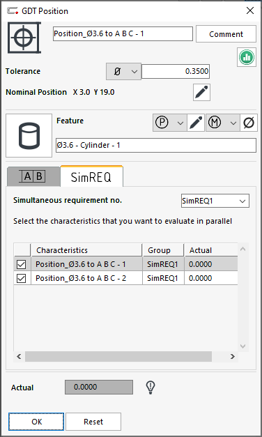

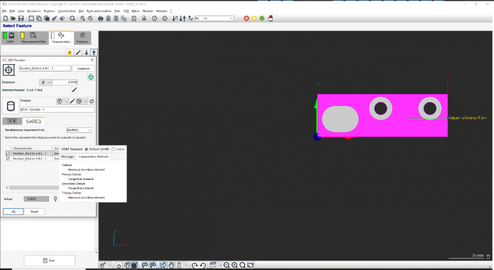

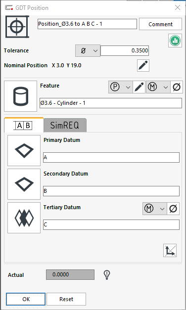

[Ra...] Posted April 24, 2025 Share Posted April 24, 2025 Hello, I'm new to working with CMM and Calypso 2022. I need some guidance on selecting the correct option in Calypso to inspect the true position of this part. Depending on the option I choose, the part either passes or fails the inspection. I’m not sure what the best approach is. Could someone please help me understand which option to use, or advise me on how to properly inspect the true position for this part? See the following screenshots. Thank you, Link to comment https://qualityforum.zeiss.com/topic/23237-help-with-true-position-diamter/ Share on other sites More sharing options...
[Ma...] Posted April 24, 2025 Share Posted April 24, 2025 Datum C should be a feature which allows MMB - so perhaps symmetry plane or symmetry point ( it's not the same as symmetry from construction menu! ) 1 Link to comment https://qualityforum.zeiss.com/topic/23237-help-with-true-position-diamter/#findComment-130875 Share on other sites More sharing options...

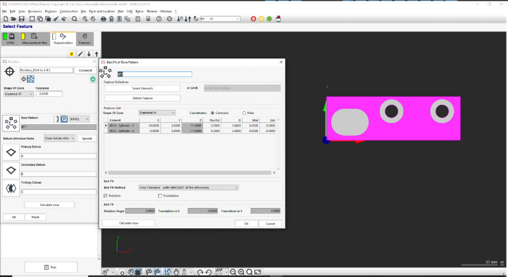

[Ri...] Posted April 24, 2025 Share Posted April 24, 2025 The legacy GD&T will not allow you to use MMB, even with a Best-Fit Pattern. You will need to use the new GD&T engine to evaluate this. Pay attention to which standard you use. 1 Link to comment https://qualityforum.zeiss.com/topic/23237-help-with-true-position-diamter/#findComment-130879 Share on other sites More sharing options...
[ni...] Posted April 24, 2025 Share Posted April 24, 2025 like on the draft the nominals of the TP should be 19 and 3, the datum C is the center axis of the oblong. 1 Link to comment https://qualityforum.zeiss.com/topic/23237-help-with-true-position-diamter/#findComment-130899 Share on other sites More sharing options...
[To...] Posted April 24, 2025 Share Posted April 24, 2025 (edited) Please sign in to view this quote. Because the Datum C identifier is in-line with the dimension line, it implies that Datum C is based on both sides of the slot. Symmetry Plane, as pointed out by others, is the correct feature. Edited April 24, 2025 2 Link to comment https://qualityforum.zeiss.com/topic/23237-help-with-true-position-diamter/#findComment-130905 Share on other sites More sharing options...
[Ri...] Posted April 24, 2025 Share Posted April 24, 2025 I apologize, I didn't see the version. You will most likely need to follow these instructions if you truly want something similar to datum shift. https://portal.zeiss.com/knowledge-base?id=522754 1 Link to comment https://qualityforum.zeiss.com/topic/23237-help-with-true-position-diamter/#findComment-130945 Share on other sites More sharing options...

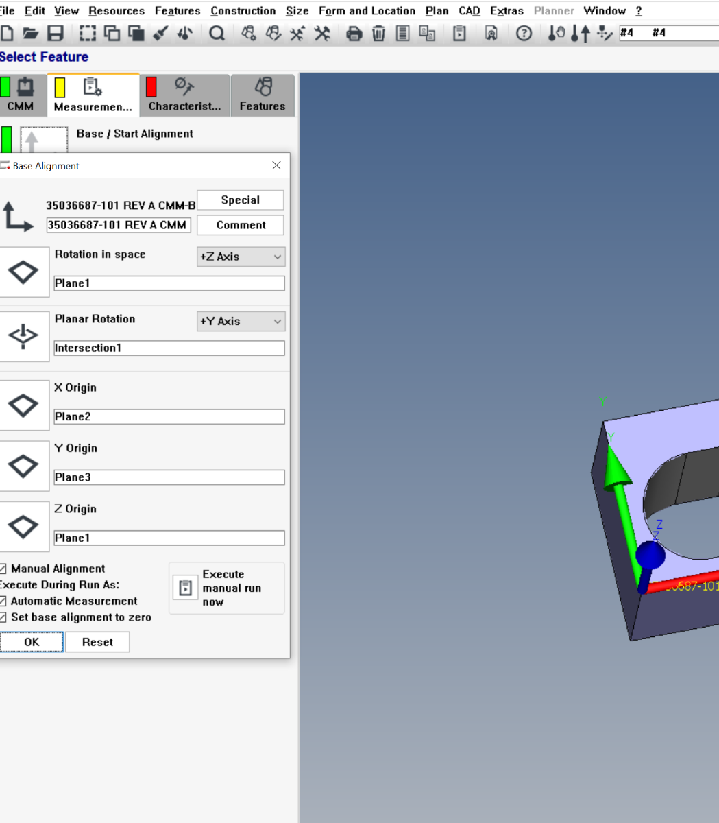

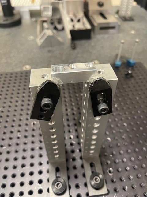

[Da...] Posted April 28, 2025 Share Posted April 28, 2025 As an aside, I notice you are using a glue gun for part mounting. I highly recommend you stop using glue, and instead get a smallish toolmakers grinding vise, one with small steps on the edges to hold small parts like this. The C datum is the location of the slot, with datum shift resulting on width greater than the smallest toleranced width. Generally, a GD&T setup is based on the "3-2-1" alignment type, or more correctly "plane-line-point". Your primary in this case is the bottom of the part, which can't be directly measured on your setup (but could be, if you use a grinding vise as I mentioned). This creates the z=0 origin, plus fixes the roll and pitch rotations of said plane. Secondary would be the LINE created on the right side of the part. You entered a planar feature, but when creating this alignment, the machine will use a "resultant line" calculated from the plane. I assume that this is will be parallel to the primary datum in Calypso (in days gone by sometimes CMM programs would fit a line at some odd angle and screw up your vectors). This will fix your x=0 origin and y-axis orientation, and fixes the yaw rotation to the Y+ axis. Your tertiary would be the center point of the width of the slot, with MMC variation resultant from the actual slot width measured. It seems you created a planar feature of this based on the midpoint of the 2 planar surfaces of the slot, from which the Calypso software will create a resultant point based on the "center-point" of this plane. Since the only datum shift is on the tertiary datum, and that only affects the Y-axis with no rotational component, you CAN apply datum shift after measurement if all you have is an RFS dimension. This can be added afterwards only to the Y-axis data, but you'll have to do that manually. In years past, I would just mark-up a printout of the RFS dimensions, and add a note and maybe also a spreadsheet showing the extra bonus based ONLY on the tertiary datum. If it actually passes on the simple RFS alignment, you don't need to do anything else. Link to comment https://qualityforum.zeiss.com/topic/23237-help-with-true-position-diamter/#findComment-131079 Share on other sites More sharing options...
[Pa...] Posted December 7, 2025 Share Posted December 7, 2025 Be careful with statements about how GD&T is "generally" applied. I work exclusively with cylinders. 15 years in this busy CMM room as the only programmer and I've seen maybe 100 parts come through (all were fixtures for our processes, not customer material) that would be appropriate to use a "plane-line-point" system. This only applies where a plane is the primary datum because it controls exactly 3 DOF. A cylinder in primary constrains 4 DOF so we'd use cylinder-plane-(some clocking datum: circle, line, etc) or cylinder-clock-point. Also - Adding datum shift where MMB is invoked after the fact is possible if and only if it is applied to both holes simultaneously. Same direction, same magnitude. You must not change the shift for individual FOS separately like you do with MMC. I agree that in this case it's totally possible; just making the distinction. Link to comment https://qualityforum.zeiss.com/topic/23237-help-with-true-position-diamter/#findComment-143143 Share on other sites More sharing options...
