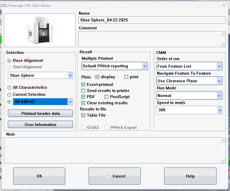

[Ri...] Posted April 24, 2025 Share Posted April 24, 2025 I have a para fie that sets a part number (PN) from an external source Then I have a selectCase for the part numbers for setRunID(). //Pre Settings: cd=(getActualInspectionDir()) systemCallWithWait(cd+"\"+"parameters_Eaton_R2.exe") cd=(getActualInspectionDir()) readPCMFile(cd+"\"+"runpart.para") if PN==0 cncBreak() endif //Start MiniPlan selection 04.24.25 RS selectCase PN case "00-428363" setRunID("00-428363") case "00-569754" setRunID("00-569754") case "00-571009" setRunID("00-571009") endSelect //getRunID() The first line in the para file is: PN = "00-428363" (For this example). I must have something wrong, as it is not setting the runID and running what the user selects from the para file, it runs everything. There are mini plans named as the select case shows. Any assistance is appreciated. Link to comment https://qualityforum.zeiss.com/topic/23239-setrunid-using-pcm/ Share on other sites More sharing options...

[Ri...] Posted April 24, 2025 Share Posted April 24, 2025 Newbie here, but I really don't see any issues with what you are doing unless there is some bit of code later on that is overwriting the setRunID() portion. I think though that you could skip the select case portion of the code though, right? If the PN that the operator is selecting matches the Mini-Plan ID, then why can't you just set it to setRunID(PN)? 1 Link to comment https://qualityforum.zeiss.com/topic/23239-setrunid-using-pcm/#findComment-130885 Share on other sites More sharing options...
[Ri...] Posted April 24, 2025 Share Posted April 24, 2025 Correction, this would need to be in the Pre-Settings. The Post-Settings isn't going to run until it is finished (and most likely you have this on the measurement plan level, so it won't run until the very end). Link to comment https://qualityforum.zeiss.com/topic/23239-setrunid-using-pcm/#findComment-130887 Share on other sites More sharing options...
[Ri...] Posted April 24, 2025 Author Share Posted April 24, 2025 (edited) Please sign in to view this quote. You are 100% correct! Thank you for the tip. This is in the Pre Settings. Edited April 24, 2025 Link to comment https://qualityforum.zeiss.com/topic/23239-setrunid-using-pcm/#findComment-130889 Share on other sites More sharing options...

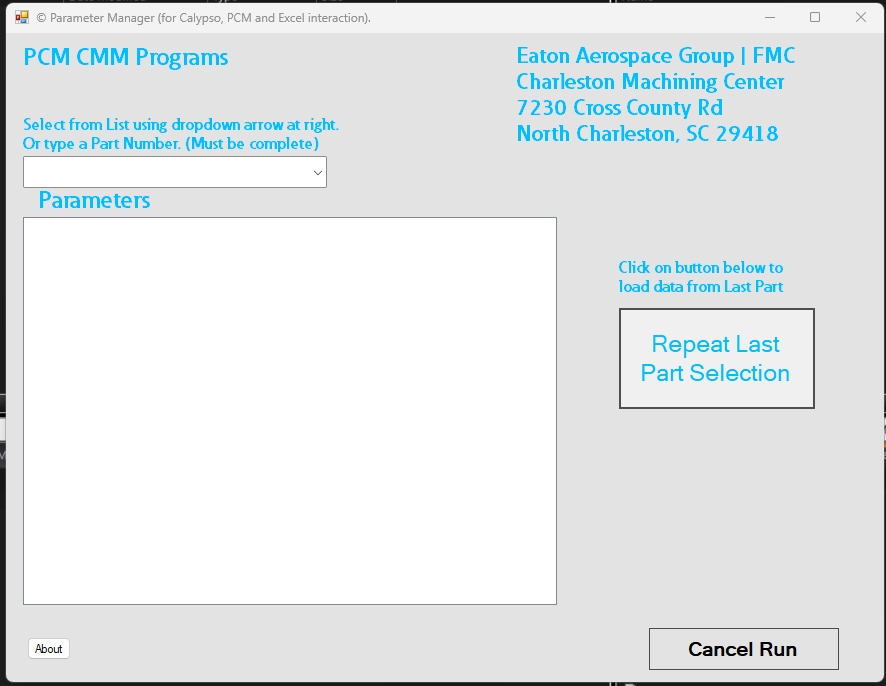

[Ri...] Posted April 24, 2025 Author Share Posted April 24, 2025 We have something similar but written in VB.net, this interface handles about 200+ PCM/Para programs. (Not sure who created the original interface, I wrote this one to keep up with Windows updates). Link to comment https://qualityforum.zeiss.com/topic/23239-setrunid-using-pcm/#findComment-130907 Share on other sites More sharing options...
[Ri...] Posted April 24, 2025 Author Share Posted April 24, 2025 (edited) Well color me embarrassed. It works just fine when you have the Mini Plan box Checked with any selection. Adapted code. //Pre Settings: cd=(getActualInspectionDir()) //systemCallWithWait(cd+"\"+"parameters.exe") systemCallWithWait(cd+"\"+"parameters_Eaton_R2.exe") cd=(getActualInspectionDir()) readPCMFile(cd+"\"+"runpart.para") //Set MiniPlan selection 04.24.25 RS setRunID(PN) fileName = "setRunID.txt" //message(getRunID()) //For testing //cncBreak() //For testing if PN==0 cncBreak() endif Edited April 24, 2025 1 Link to comment https://qualityforum.zeiss.com/topic/23239-setrunid-using-pcm/#findComment-130911 Share on other sites More sharing options...

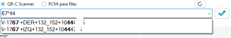

[I...] Posted April 24, 2025 Share Posted April 24, 2025 Please sign in to view this quote. so .... you have to type completelly the part number? 😬, better ask chatGPT for an autocomplete combobox with wildcard: Link to comment https://qualityforum.zeiss.com/topic/23239-setrunid-using-pcm/#findComment-130917 Share on other sites More sharing options...
[Ri...] Posted April 24, 2025 Author Share Posted April 24, 2025 Please sign in to view this quote. The user can type or use the dropdown list that is auto populated by an excel file. Link to comment https://qualityforum.zeiss.com/topic/23239-setrunid-using-pcm/#findComment-130919 Share on other sites More sharing options...
[Ch...] Posted April 24, 2025 Share Posted April 24, 2025 you could probably update your program pre-assignment to choose a mini-plan so the error no longer occurs, and further add PCM to check if startSettings are set to "All characteristics" or "current selection" to force it to default mini-plan until the selection screen is shown, etc.. Good luck !! Link to comment https://qualityforum.zeiss.com/topic/23239-setrunid-using-pcm/#findComment-130933 Share on other sites More sharing options...
[I...] Posted April 24, 2025 Share Posted April 24, 2025 (edited) Please sign in to view this quote. wildcards is much better believe me, anyway maybe not your problem here but you could have other problems latter so better change readPCMFile() to: runPCMFile(cd+"\"+"runpart.para") Edited April 24, 2025 Link to comment https://qualityforum.zeiss.com/topic/23239-setrunid-using-pcm/#findComment-130935 Share on other sites More sharing options...
