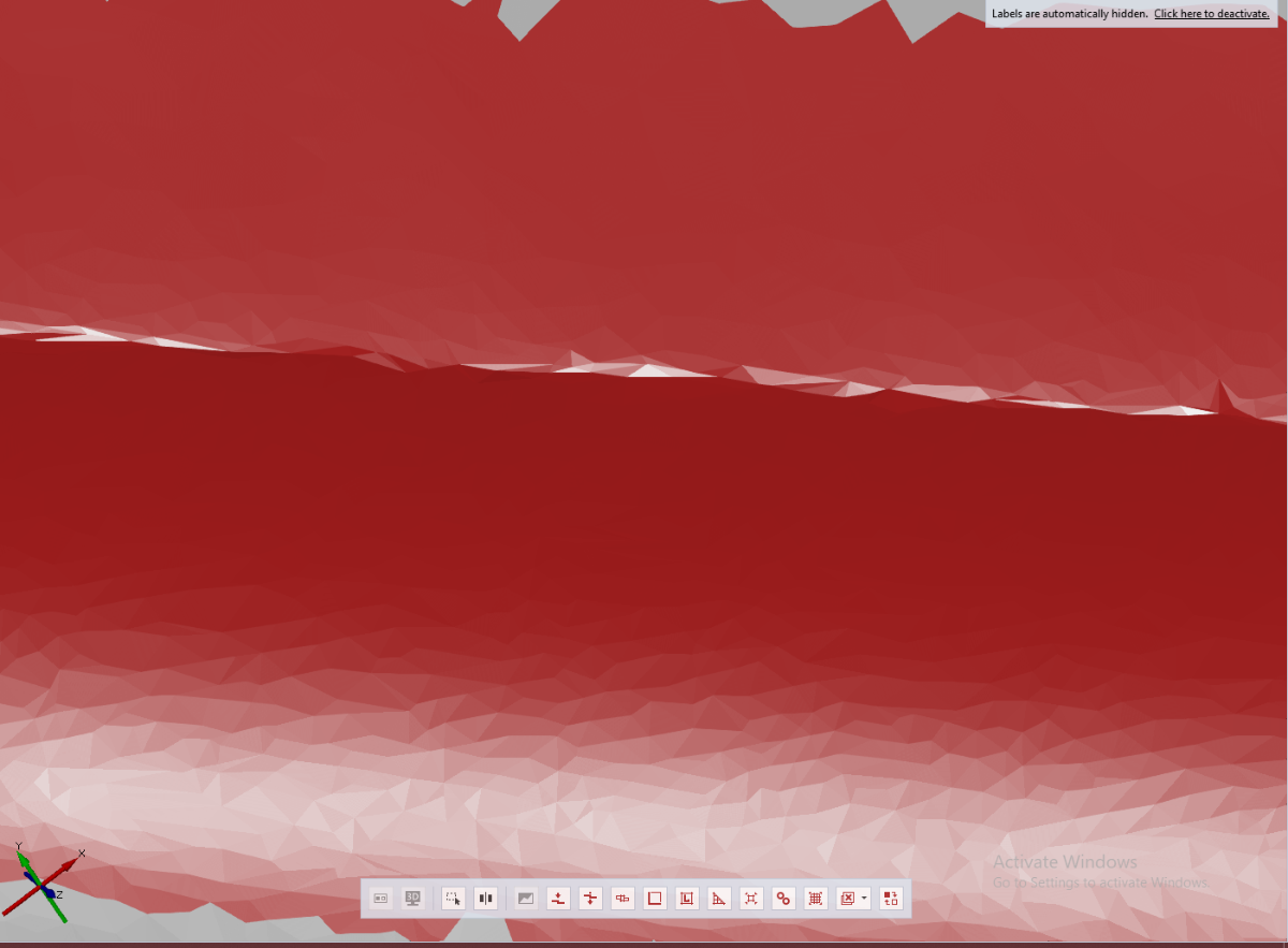

[Mi...] Posted April 24, 2025 Share Posted April 24, 2025 Hi there, This question pertains to GOM 2022 inspect and the ATOS 5 blue-light scanner. I'm scanning a part with a very sharp feature line. The goal is to use this scan in the future to cut to on a CNC machine. The sharp edge looks okay until I zoom in--then it becomes a jagged mess of irregular triangles. I've tried every combo of post-processing settings I can think of, and I still get some degree of the same issue. Is this something that can be remedied by scanning technique, or postprocessing of the mesh? And is there any way to "sharpen" the edges of the mesh, so to speak? Or is this just the nature of scanning a very sharp edge, and this is as good as it gets? Thanks in advance. Link to comment https://qualityforum.zeiss.com/topic/23249-sharp-edges-in-mesh-appear-jagged-and-rough/ Share on other sites More sharing options...

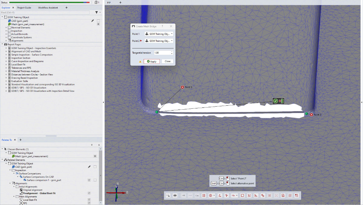

[Je...] Posted April 28, 2025 Share Posted April 28, 2025 Hey Michael, What scale are we talking about here? So which MV is used on the ATOS 5 and what order of magnitude does this sharp edge have and how precisely do you want it to be resolved? Furthermore, the quality settings or scanning parameters are also important to know. With this knowledge, a better representation of the edge may be possible. Gruß, Jens 1 Link to comment https://qualityforum.zeiss.com/topic/23249-sharp-edges-in-mesh-appear-jagged-and-rough/#findComment-131037 Share on other sites More sharing options...
[Mi...] Posted April 28, 2025 Author Share Posted April 28, 2025 Hey Jens, MV I'm told is 700, using a medium lens. I used a couple thin layers of Spot Check to eliminate glare. The camera is set on High Quality and Fast Scan, and the Post-Processing is set on Standard. This was the best result out of 24 possible setting configurations that we could find. As far as order of magnitude and scale, this is subtle feature line on a punch die, used to stamp a hood panel for an automobile, so this is not "sharp" as in a knife blade or something similar, it's a "sharp line" that you would see on car. I don't know how to precisely measure that, I would guess the "tip" of the line is less than 0.25 MM. How I would like it to be resolved ideally would be through post-processing, so we wouldn't have to re-scan. Someone here thought there was a way to highlight the problem areas and perform some kind of action within ATOS to make the triangles smaller or something like this. Link to comment https://qualityforum.zeiss.com/topic/23249-sharp-edges-in-mesh-appear-jagged-and-rough/#findComment-131085 Share on other sites More sharing options...

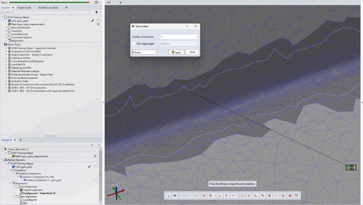

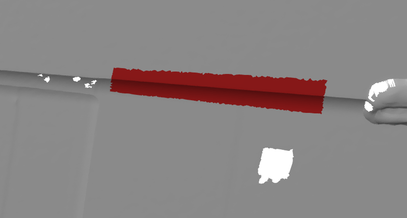

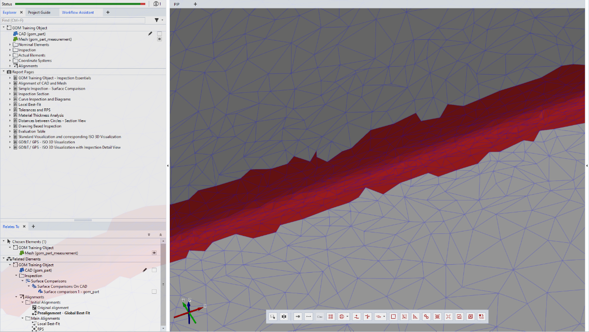

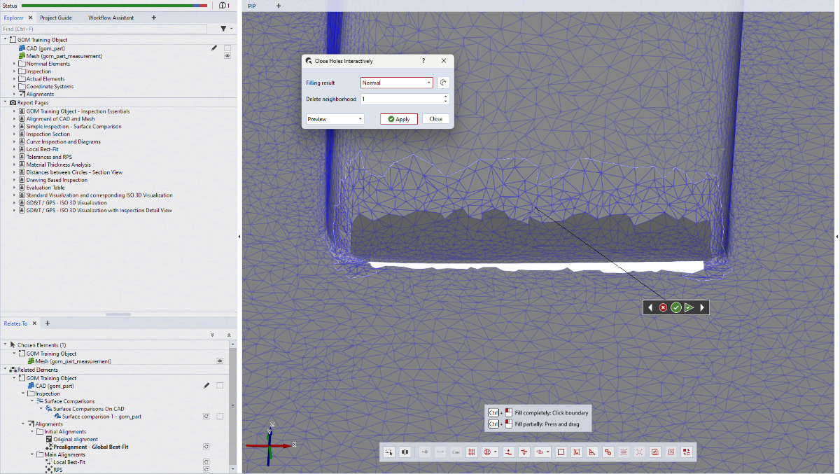

[Ma...] Posted April 29, 2025 Share Posted April 29, 2025 Hey Michael, why did you use Fast scan instead of Full resolution? Is it a manual or automated measuring system? The relative sensor position to the edge also plays a role. You can still avoid the triple scan points. However, the MV 700 is only partially suitable for resolving sharp edges. A smaller MV for these areas would be preferable. What you mean by post-processing is actually the Mesh Editing workspace. There you can refine the mesh and edit it differently. For example, you could cut out the area and then fill the area to the left and right of the bridge with a bridge that runs exactly along the edge. But be careful, this is no longer real data. Greetings Manuel 1 Link to comment https://qualityforum.zeiss.com/topic/23249-sharp-edges-in-mesh-appear-jagged-and-rough/#findComment-131123 Share on other sites More sharing options...
