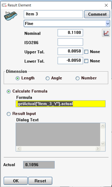

[Ca...] Posted April 24, 2025 Share Posted April 24, 2025 Is there a way to not show _x, _y or _z when using caliper distance in Piweb reporting ? Link to comment https://qualityforum.zeiss.com/topic/23251-piweb-reporting/ Share on other sites More sharing options...
[Ma...] Posted April 24, 2025 Share Posted April 24, 2025 From what i know you can not remove that. Maybe some formating in PiWeb editor, but i have no experience for that. Try posting at PiWeb section - there are methods for removing unwanted things from protocol. Lookup in PiWeb section. 1 Link to comment https://qualityforum.zeiss.com/topic/23251-piweb-reporting/#findComment-130971 Share on other sites More sharing options...
[DW...] Posted April 24, 2025 Share Posted April 24, 2025 Please sign in to view this quote. Seems like extra work but you could do result elements if you really don't want to see the Z 2 Link to comment https://qualityforum.zeiss.com/topic/23251-piweb-reporting/#findComment-130973 Share on other sites More sharing options...
[Ca...] Posted April 24, 2025 Author Share Posted April 24, 2025 yes I had the same idea. Link to comment https://qualityforum.zeiss.com/topic/23251-piweb-reporting/#findComment-130975 Share on other sites More sharing options...
[Ma...] Posted April 24, 2025 Share Posted April 24, 2025 Also - if you want to get rid of it because of dimension name goes into QC app, then i am doing naming as "317_5; some text" - this will report dimension like you have, but i am saving that into QDAS and with LUA script i am getting rid of everything after ";" So i reduce that like this "317_5; left_Z" -> "317_5" 1 Link to comment https://qualityforum.zeiss.com/topic/23251-piweb-reporting/#findComment-130979 Share on other sites More sharing options...

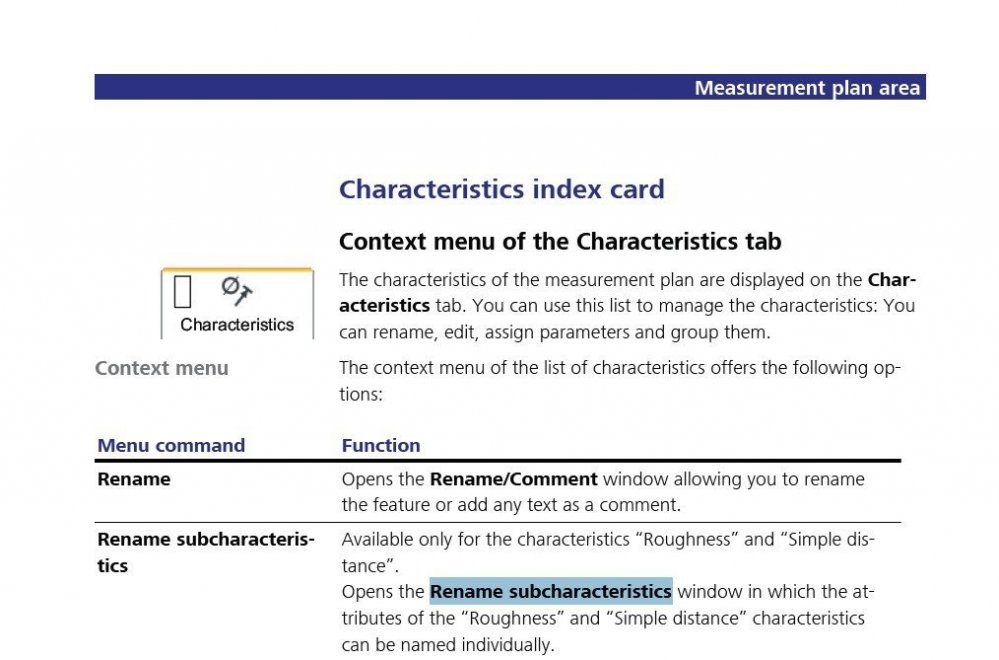

Popular Post [Mi...] Posted April 25, 2025 Popular Post Share Posted April 25, 2025 Right click on the caterpillar distance and select "Rename subcharacteristics" and you can use a name of your choice. 6 Link to comment https://qualityforum.zeiss.com/topic/23251-piweb-reporting/#findComment-130995 Share on other sites More sharing options...
[Ri...] Posted April 25, 2025 Share Posted April 25, 2025 Dang - I always forget about that. So much simpler than my solution. Haha. Link to comment https://qualityforum.zeiss.com/topic/23251-piweb-reporting/#findComment-131007 Share on other sites More sharing options...
[Ma...] Posted April 25, 2025 Share Posted April 25, 2025 Please sign in to view this quote. From what version is this possible? I also forgot that, but because of old Calypso it's gone from memory. Funny note - available only for roughness and simple distance :-) not sure about that Link to comment https://qualityforum.zeiss.com/topic/23251-piweb-reporting/#findComment-131009 Share on other sites More sharing options...

[Ba...] Posted April 29, 2025 Share Posted April 29, 2025 I'm pretty sure it would report both features but to get our caliper distance characteristics to report to the SPC software we use, we have to use a result element with a formula to drop the coordinate subtitle. We don't use PIWeb other than to report out calibration results. The caliper distance characteristics may be able to be hidden after using the result element? Just an idea getActual("Caliper Distance Feature").actual Link to comment https://qualityforum.zeiss.com/topic/23251-piweb-reporting/#findComment-131169 Share on other sites More sharing options...
[Ri...] Posted April 29, 2025 Share Posted April 29, 2025 If you are exporting to a 3rd party SPC software via the Table File, I'd look into just creating a Python (or whatever coding language you want to) to parse the data for you. Link to comment https://qualityforum.zeiss.com/topic/23251-piweb-reporting/#findComment-131171 Share on other sites More sharing options...
