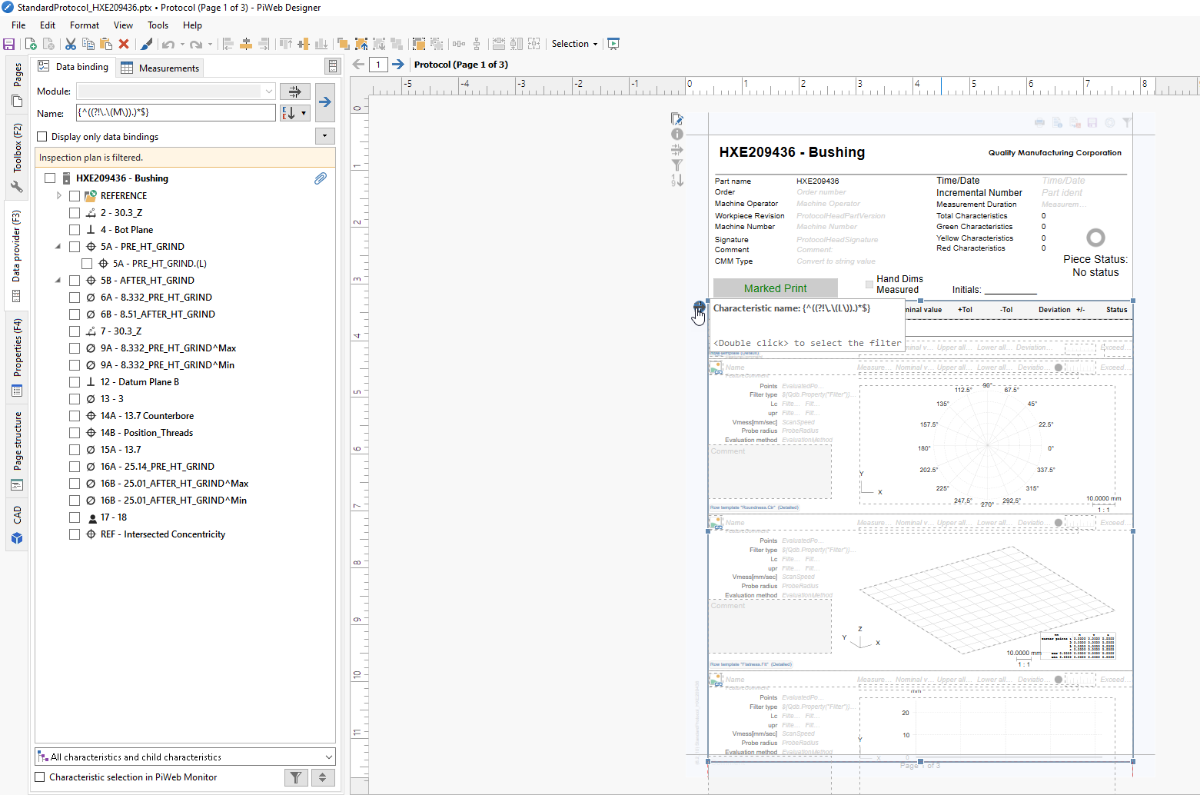

[Ju...] Posted April 25, 2025 Share Posted April 25, 2025 Does anyone know how to have two filters in the protocol page structure at the same time? My cursor in the above picture shows that there is one, but I cannot add another. I have position characteristics in my program using both LMC and MMC. In the above example the characteristic name {^((?!\.\(L\)).)*$} filters out the RFS result for the LMC position characteristic, but it does not get it to filter out the RFS from the LMC and MMC position characteristics at the same time. I've inputting several different things in the NAME field (see top left of picture) such things like this... {^((?!\.\(L\)).)*$} & {^((?!\.\(M\)).)*$} but that does not work. Individually they work just fine, but I cannot get both to work at the same time. Link to comment https://qualityforum.zeiss.com/topic/23261-insert-2-characteristic-name-filters/ Share on other sites More sharing options...
[No...] Posted May 22, 2025 Share Posted May 22, 2025 Can you not just combine them to one regex expression: {^((?!\.\(L\))((?!\.\(M\))).)*$} or this {^((?!\.\(L\))(?!.?\.\(M\)).)*$} or this {^(?!.*\.\(L\))(?!.*\.\(M\)).*$} or this {^((?!\.\((L|M)\)).)*$} 1 Link to comment https://qualityforum.zeiss.com/topic/23261-insert-2-characteristic-name-filters/#findComment-132637 Share on other sites More sharing options...
[Lu...] Posted May 22, 2025 Share Posted May 22, 2025 This should work: {^((?!\.\(M|L\)).)*$} https://portal.zeiss.com/knowledge-base?id=458620 1 Link to comment https://qualityforum.zeiss.com/topic/23261-insert-2-characteristic-name-filters/#findComment-132639 Share on other sites More sharing options...
