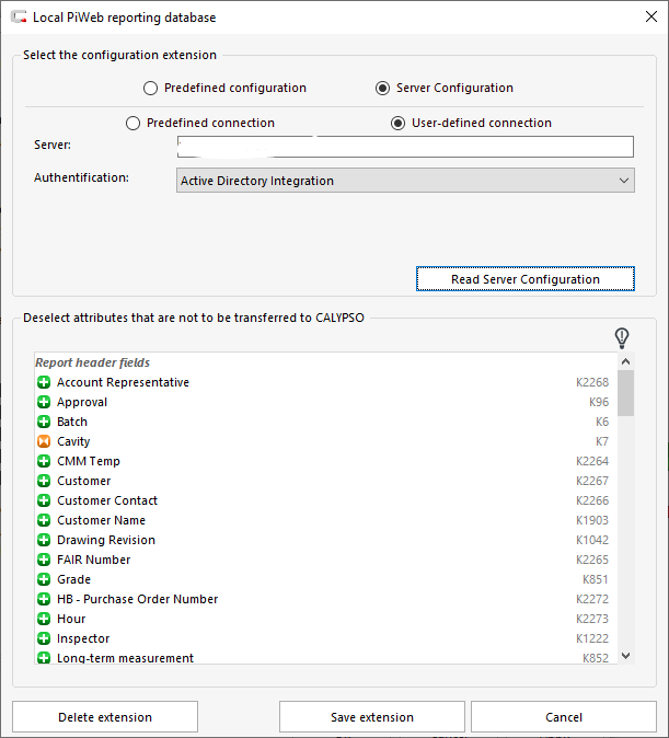

[Ri...] Posted April 28, 2025 Share Posted April 28, 2025 Does anyone know where this information is being stored on the local PC? Link to comment https://qualityforum.zeiss.com/topic/23279-local-piweb-report-database-extension/ Share on other sites More sharing options...
[AS...] Posted June 9, 2025 Share Posted June 9, 2025 Hi Richard I found this database location - Go to Extra-Settings-Environment -then Click PiWeb Reporting on Right hand side menu -Now you will see a Big rectangle button named “ Database Extension “ , click that button - select Predefined configuration -Click on Drop down list -Select “Default” And finally you are there , what you are looking for. i hope these details will help you. take Care Link to comment https://qualityforum.zeiss.com/topic/23279-local-piweb-report-database-extension/#findComment-133413 Share on other sites More sharing options...
