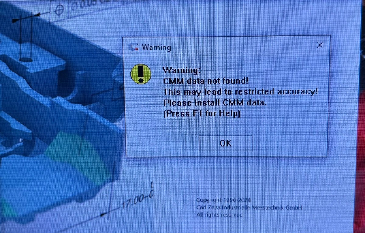

[FL...] Posted April 30, 2025 Share Posted April 30, 2025 What is this error? Link to comment https://qualityforum.zeiss.com/topic/23295-cmm-data-not-found/ Share on other sites More sharing options...
[DW...] Posted April 30, 2025 Share Posted April 30, 2025 Please sign in to view this quote. Please sign in to view this username. I promise I am not being snarky, have you tried F1 to see what the help file says? 1 Link to comment https://qualityforum.zeiss.com/topic/23295-cmm-data-not-found/#findComment-131215 Share on other sites More sharing options...
[Ja...] Posted April 30, 2025 Share Posted April 30, 2025 Two guesses... you are either not connected to your CMM or if you are in an offline planner it is not happy you do not have a CMM/model selected. Try Extras > Settings > CMM > Machine in Calypso if is the latter.. A little more information would be helpful. Link to comment https://qualityforum.zeiss.com/topic/23295-cmm-data-not-found/#findComment-131221 Share on other sites More sharing options...
[Ca...] Posted April 30, 2025 Share Posted April 30, 2025 This also can mean that your CMM has not homed yet. Close CALYPSO and restart the CMM, drive the probe head into the center of the machine, then restart CALYPSO and see if the CMM can home. Link to comment https://qualityforum.zeiss.com/topic/23295-cmm-data-not-found/#findComment-131223 Share on other sites More sharing options...
[Ky...] Posted April 30, 2025 Share Posted April 30, 2025 https://portal.zeiss.com/knowledge-base?id=1475168 As Caitlin mentioned, this is almost always caused by the CMM not being homed properly when it starts up, though I believe there are other things that can hypothetically cause it to pop up as well. Link to comment https://qualityforum.zeiss.com/topic/23295-cmm-data-not-found/#findComment-131261 Share on other sites More sharing options...
[No...] Posted May 5, 2025 Share Posted May 5, 2025 I had this error a few times without a clear relation to the CMM not being homed properly. It just appeared out of nowhere. A reboot of the whole system (PC and CMM) usually made it go away. Link to comment https://qualityforum.zeiss.com/topic/23295-cmm-data-not-found/#findComment-131493 Share on other sites More sharing options...
[Be...] Posted August 19, 2025 Share Posted August 19, 2025 I have had this alarm a few times after an operator has crashed. After the crash the machine alarms out whenever you try to move in the X or Y axis, even when trying to home. If you remove the cover on the motor for the X axis (I believe it is for the X axis anyway) you'll find a reset switch underneath. If you press this switch and it clicks in place then the motor was likely tripped in the crash. You should be able to continue as normal after. Not sure if this would be correct for other machines but this has definitely been the case on a couple of the Duramax machines we have. I hope this helps someone! Link to comment https://qualityforum.zeiss.com/topic/23295-cmm-data-not-found/#findComment-136957 Share on other sites More sharing options...
