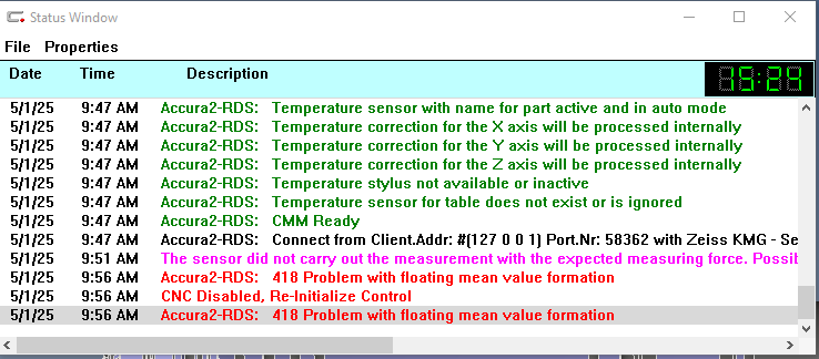

[Ja...] Posted May 1, 2025 Share Posted May 1, 2025 Hi all Any advice on probe just stopping in mid program (different stages), and drives turning off. Its as though something has obstructed it, but yet there has been no collisions. I have also cleaned the X, Y & Z scales with no success. I am met with a '418 Problem with floating mean value formation' error. See below; Thanks Jack Link to comment https://qualityforum.zeiss.com/topic/23311-probe-stopping-mid-air-drives-off/ Share on other sites More sharing options...

[Ky...] Posted May 1, 2025 Share Posted May 1, 2025 418 floating mean error is usually a probe head issue to my knowledge. When the sensor takes a points, its actually taking several, but it will only work if the values it measures is within a certain range (I do not know exactly what that range is off the top of my head). Checking scales and air pressure is a good idea, but I tend to doubt it would create a 418 error. It could also be something with the measurement itself (like if the part is moving slightly while you are measuring it), but in general it is probably a probe head issue. 1 Link to comment https://qualityforum.zeiss.com/topic/23311-probe-stopping-mid-air-drives-off/#findComment-131385 Share on other sites More sharing options...

[Ke...] Posted May 2, 2025 Share Posted May 2, 2025 Kyle is correct, the Floating Mean Value error means that the CMM cannot get the reading of the points to converge to a stable value. This is most commonly caused by a failing probehead, though in some scenarios such as poor fixturing or flexible parts it can be caused by movement of the part itself during probing. As you have indicated this is happening at different points throughout the program, I would recommend verifying the stability of your part holding, but most likely you are seeing the beginning stages of probehead failure, particularly if it happens in midair. A few other things you could try include cleaning the contacts of the XXT probehead itself (VERY CAREFULLY), ensuring the attaching ring of the XXT to the RDS carrier is tight, and cleaning the contacts of the RDS carrier (VERY CAREFULLY). These do sometimes resolve this issue on systems running the RDS XXT Link to comment https://qualityforum.zeiss.com/topic/23311-probe-stopping-mid-air-drives-off/#findComment-131459 Share on other sites More sharing options...
