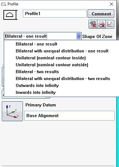

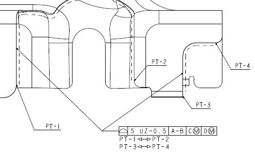

[Ke...] Posted May 2, 2025 Share Posted May 2, 2025 Hello, What would be the correct way to enter this into a profile characteristic? I am programming on an offline seat CALYPSO 2017 Version 6.4 (28.06.2017) that will be ran on CALYPSO 2020 Version 7.0.2003 (13.6.2023) Thank you! Link to comment https://qualityforum.zeiss.com/topic/23321-profile-question/ Share on other sites More sharing options...
[Ha...] Posted May 2, 2025 Share Posted May 2, 2025 If I'm looking at this correctly, a Bilateral with unequal distribution would make the most sense with one side set to 0.5 out of the material. Link to comment https://qualityforum.zeiss.com/topic/23321-profile-question/#findComment-131463 Share on other sites More sharing options...
