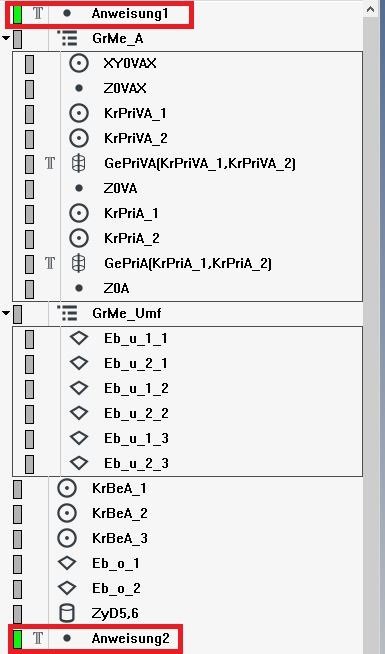

[Je...] Posted May 6, 2025 Share Posted May 6, 2025 (edited) Is it the pre-setting of the group you are talking about? If so, then your "check features" shouldn´t be inside the group, but before, because if they are inside the group, the pre-settings are executed before the "check features" run. If you want to have them all inside a group, you can make something like a "master group" for the group with pre-settings and the "check features". Alternatively you can do it like I do (works only while run from feature): set a theoretical feature (point in my case, but should work with every theoretical feature) where you need your code, and in the pre- or post-settings of this feature place your code. To get it executet, you need to place "addMe("feature1", "feature2"...)" in the pre-settings of your plan or in your "inspection_start_pcm.txt". Edited May 6, 2025 1 Link to comment https://qualityforum.zeiss.com/topic/23341-pcm-subsequent-evaluation/#findComment-131601 Share on other sites More sharing options...

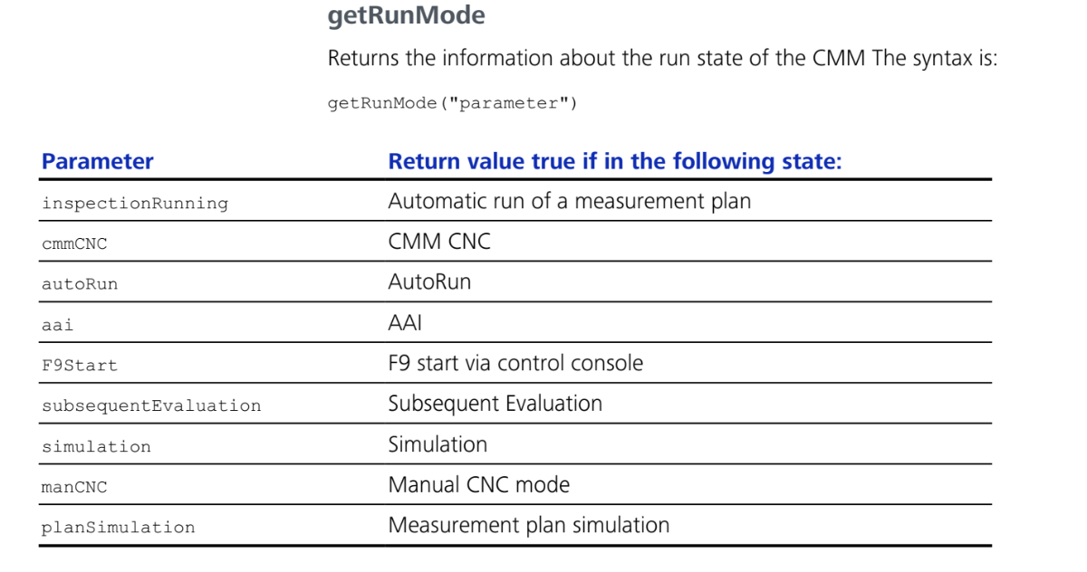

[Ri...] Posted February 19 Author Share Posted February 19 (edited) Just an FYI. There is actually a super simple and documented command for this. I guess I should have just read the documentation. hahaha. getRunMode() So just write a simple if statement. if getRunMode("subsequentEvaluation") == true do something endif Edited February 19 1 1 Link to comment https://qualityforum.zeiss.com/topic/23341-pcm-subsequent-evaluation/#findComment-146447 Share on other sites More sharing options...
