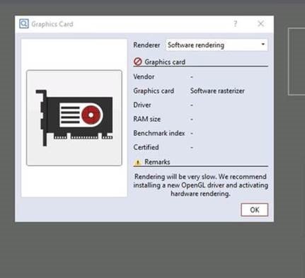

[ca...] Posted May 7, 2025 Share Posted May 7, 2025 Hello everyone, Time to time, I encounter Graphics Card window in ZEISS software. I need to understand why this window keeps popping up. I can pass the window by changing the software rendering to hardware rendering but it needs to be passed manually which prevents my scripts to run automatically. Does ZEISS software has some periodic checks to analyze hardware or it has some bug when running scripts automatically too often? Is there some way to pass this rendering window or any other alternative to check whether the system is able to detect graphics card before initializing the new project or inspection task? Thanks, Canset Link to comment https://qualityforum.zeiss.com/topic/23361-about-graphics-card-window-problem/ Share on other sites More sharing options...
[Ky...] Posted May 14, 2025 Share Posted May 14, 2025 Hi Cansetm, the notification is telling you need to update the OpenGL driver. if this is a Zeiss PC you can type in the PC model and look up the drivers list and update it. this driver will need to be updated to then switch to hardware rendering. https://techguide.zeiss.com/en/zeiss-inspect-2025/article/cmd_sys_show_graphics_card_info.html ZEISS Quality Tech Guide ZEISS Quality Tech Guide I have copied 3 links that should help and point you in the right direction. 1 Link to comment https://qualityforum.zeiss.com/topic/23361-about-graphics-card-window-problem/#findComment-132129 Share on other sites More sharing options...
[Ny...] Posted February 4 Share Posted February 4 Hi, is there an option to force hardware rendering or not check to begin with? I know my PC is compatible and updated, the problem only appears when starting atos more than a couple of times simultaneously. I would like to be able to tell it to just continue using hardware rending so I don't have to manually intervene every time I run a script Link to comment https://qualityforum.zeiss.com/topic/23361-about-graphics-card-window-problem/#findComment-145531 Share on other sites More sharing options...
