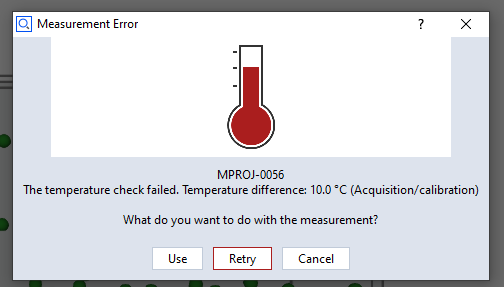

[El...] Posted May 7, 2025 Share Posted May 7, 2025 When I want to perform a scan, I get the error in the image. What is the reason? What is the solution to the problem? I just calibrated the device. Can you help me Link to comment https://qualityforum.zeiss.com/topic/23365-the-temperature-problem/ Share on other sites More sharing options...

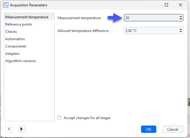

[Na...] Posted May 7, 2025 Share Posted May 7, 2025 Hi, if you calibrate at 20 °C and your measuring temperature differs more than the allowed value (10 °C in your case) this warning is coming up. You can recalibrate with the new temperature or check your temperature in the acquisition parameters (acquisition -> Acquisition parameters). In a scanbox the temperature is measured automatically (usually). 1 Link to comment https://qualityforum.zeiss.com/topic/23365-the-temperature-problem/#findComment-131723 Share on other sites More sharing options...
