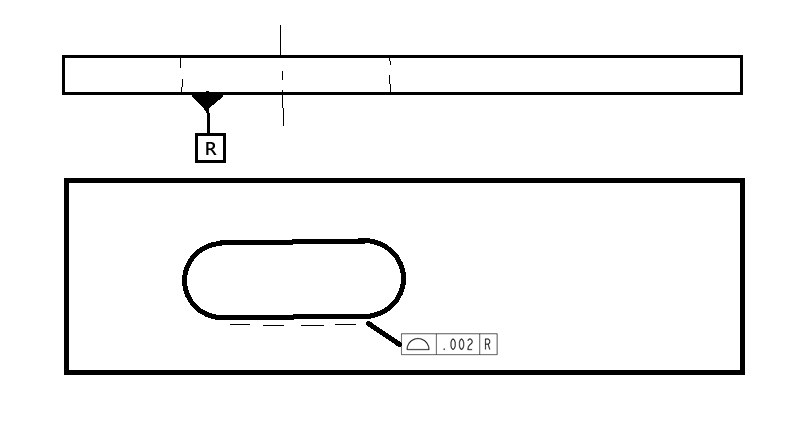

[Co...] Posted May 7, 2025 Share Posted May 7, 2025 Hey everyone! I wondered if anyone could guide me through how they would create a slot on a CAD model of a rounded slot that has a .002 Surface Profile to a single datum. I see the Profile of a Surface doesn't let me use Slot as an option to choose under the features. Wondered if anyone had any advice here. Very rough draft attached of what I am looking to do. Link to comment https://qualityforum.zeiss.com/topic/23373-creating-a-slot-in-calypso-so-i-can-apply-profile-of-a-surface-and-reference-one-datum/ Share on other sites More sharing options...
[Ri...] Posted May 7, 2025 Share Posted May 7, 2025 If you wanted to measure as a singular slot, the new GD&T (2023+) will allow you do perform a Profile of a Line and use a Slot. If you want Surface Profile, you could still measure it with the Slot Feature, but just do one at same the top and the bottom, then you could create a Free-Form surface to recall the feature points of the two Slots. 1 Link to comment https://qualityforum.zeiss.com/topic/23373-creating-a-slot-in-calypso-so-i-can-apply-profile-of-a-surface-and-reference-one-datum/#findComment-131703 Share on other sites More sharing options...
[Ma...] Posted May 7, 2025 Share Posted May 7, 2025 I am wondering if you really need to measure whole slot. By this callout they are asking for perpendicularity to plane R. Is this sketch same as on drawing or is there little circle on arrow line ( this will tell they want to have profile callout on all sides of slot ) - at least on ISO - without anything ( just what you posted ú it would apply only on face where arrow is pointing. 1 Link to comment https://qualityforum.zeiss.com/topic/23373-creating-a-slot-in-calypso-so-i-can-apply-profile-of-a-surface-and-reference-one-datum/#findComment-131721 Share on other sites More sharing options...
[Co...] Posted May 7, 2025 Author Share Posted May 7, 2025 Please sign in to view this quote. Thanks for pointing this out. It does have the little All Around circle on the leader line. I missed this on my sketch! 2 Link to comment https://qualityforum.zeiss.com/topic/23373-creating-a-slot-in-calypso-so-i-can-apply-profile-of-a-surface-and-reference-one-datum/#findComment-131731 Share on other sites More sharing options...

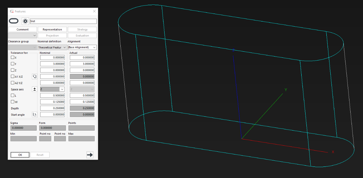

[Je...] Posted May 7, 2025 Share Posted May 7, 2025 Hi Please sign in to view this username. . Please sign in to view this username. is right on target. A slot in Calypso is considered a 2D feature when it comes to profile evaluation (which is interesting considering the feature window allows you to specify depth). It's best to decide if you want to evaluate the slot at different depths independently or as a singular freeform feature. When I need to evaluate profile of a surface, I usually scan the points in curve features a different depths and recall those points into a freeform feature. Link to comment https://qualityforum.zeiss.com/topic/23373-creating-a-slot-in-calypso-so-i-can-apply-profile-of-a-surface-and-reference-one-datum/#findComment-131733 Share on other sites More sharing options...
[Co...] Posted May 7, 2025 Author Share Posted May 7, 2025 Please sign in to view this quote. Thanks for this! I was thinking the same thing. If I could take multiple depths almost like you could a cylinder with 3 circles to form it. Take 3 slots to form the 3d shape of your slot (different depths) then recall the feature into a freeform if it would work. 1 Link to comment https://qualityforum.zeiss.com/topic/23373-creating-a-slot-in-calypso-so-i-can-apply-profile-of-a-surface-and-reference-one-datum/#findComment-131737 Share on other sites More sharing options...
