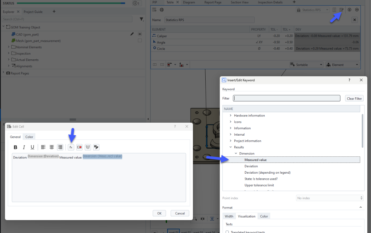

[Ma...] Posted May 12, 2025 Share Posted May 12, 2025 Hello to all, I would to know if it's possible to show in a table all the value of a measurement, like trend overview, but with the measured value. Thank you in advance. Link to comment https://qualityforum.zeiss.com/topic/23417-how-to-show-all-stages-value-in-a-table/ Share on other sites More sharing options...
[Na...] Posted May 12, 2025 Share Posted May 12, 2025 Hi Marco, there is a keyword for "measured value", which can be inserted into the table instead of the deviation: Please note, that is has to be added for every type of check once, e.g. angles and diameters etc. Nanno Link to comment https://qualityforum.zeiss.com/topic/23417-how-to-show-all-stages-value-in-a-table/#findComment-132017 Share on other sites More sharing options...
