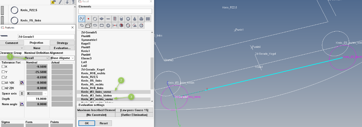

[Ed...] Posted May 14, 2025 Share Posted May 14, 2025 Hello This may be a rather silly question, but coming from Quartis (Wenzel) I am so confused. I am measuring (optically) four circles. One centre hole and three holes in a pattern around it. I want to create lines from each hole to the centre and to each other to 1: create an alignment from these lines and the centre and 2: measure the position tolerances. How can I create these lines? Thanks in advance! Link to comment https://qualityforum.zeiss.com/topic/23429-creating-a-line-between-two-circles/ Share on other sites More sharing options...
[Ch...] Posted May 14, 2025 Share Posted May 14, 2025 Hi Edwin, I hope this will help you?! : open 2-line, then change nominal definition> Recall: select youur circle. Open 1 1 Link to comment https://qualityforum.zeiss.com/topic/23429-creating-a-line-between-two-circles/#findComment-132095 Share on other sites More sharing options...
[Cl...] Posted May 14, 2025 Share Posted May 14, 2025 I would use a 3d line, which is a constructed feature. The 2d line is a measured feature. 2 1 Link to comment https://qualityforum.zeiss.com/topic/23429-creating-a-line-between-two-circles/#findComment-132097 Share on other sites More sharing options...
[Ed...] Posted May 14, 2025 Author Share Posted May 14, 2025 Thank you both! Solved it. So different to what I am used to. Thanks!! Link to comment https://qualityforum.zeiss.com/topic/23429-creating-a-line-between-two-circles/#findComment-132103 Share on other sites More sharing options...
