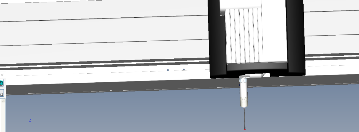

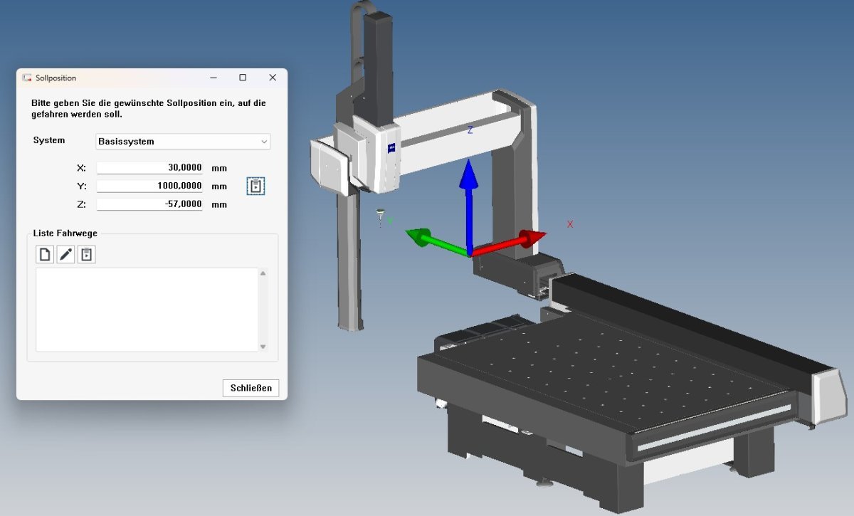

[Vi...] Posted May 14, 2025 Share Posted May 14, 2025 (edited) i want to confirm machine is reaching to axis limit or not, how can i will get this alarm in calypso planer . Edited May 14, 2025 Link to comment https://qualityforum.zeiss.com/topic/23433-how-to-check-machine-axis-limit-in-calypso-planer/ Share on other sites More sharing options...

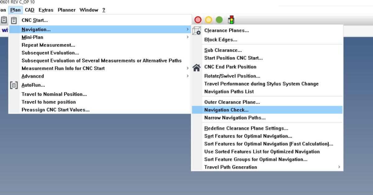

[To...] Posted May 14, 2025 Share Posted May 14, 2025 This might be what you're looking for. Link to comment https://qualityforum.zeiss.com/topic/23433-how-to-check-machine-axis-limit-in-calypso-planer/#findComment-132121 Share on other sites More sharing options...
[Vi...] Posted May 15, 2025 Author Share Posted May 15, 2025 I want alarm for machine axis limit while running simulation. Link to comment https://qualityforum.zeiss.com/topic/23433-how-to-check-machine-axis-limit-in-calypso-planer/#findComment-132181 Share on other sites More sharing options...

[No...] Posted May 16, 2025 Share Posted May 16, 2025 I don't know about the new simulation model in Calypso 2025, but up until 2024 there are no such alarms. Even worse, if you direct the CMM to travel far beyound its limits, it will happily do so: Link to comment https://qualityforum.zeiss.com/topic/23433-how-to-check-machine-axis-limit-in-calypso-planer/#findComment-132251 Share on other sites More sharing options...
[Vi...] Posted May 16, 2025 Author Share Posted May 16, 2025 yes,that is the issue i am facing not getting alarm for axis limit. Link to comment https://qualityforum.zeiss.com/topic/23433-how-to-check-machine-axis-limit-in-calypso-planer/#findComment-132263 Share on other sites More sharing options...
[No...] Posted May 16, 2025 Share Posted May 16, 2025 (edited) Well, the original concept of Planner/Simulation was to enable offline programming and collision testing between CMM parts/styli and the workpiece. It was never meant as an accurate simulation of the physical CMM's mechanics. But yes, it's a bit embarrassing that the simulated CMM doesn't even KNOW its physical limits. It should at least stop there. Edited May 16, 2025 Link to comment https://qualityforum.zeiss.com/topic/23433-how-to-check-machine-axis-limit-in-calypso-planer/#findComment-132275 Share on other sites More sharing options...
