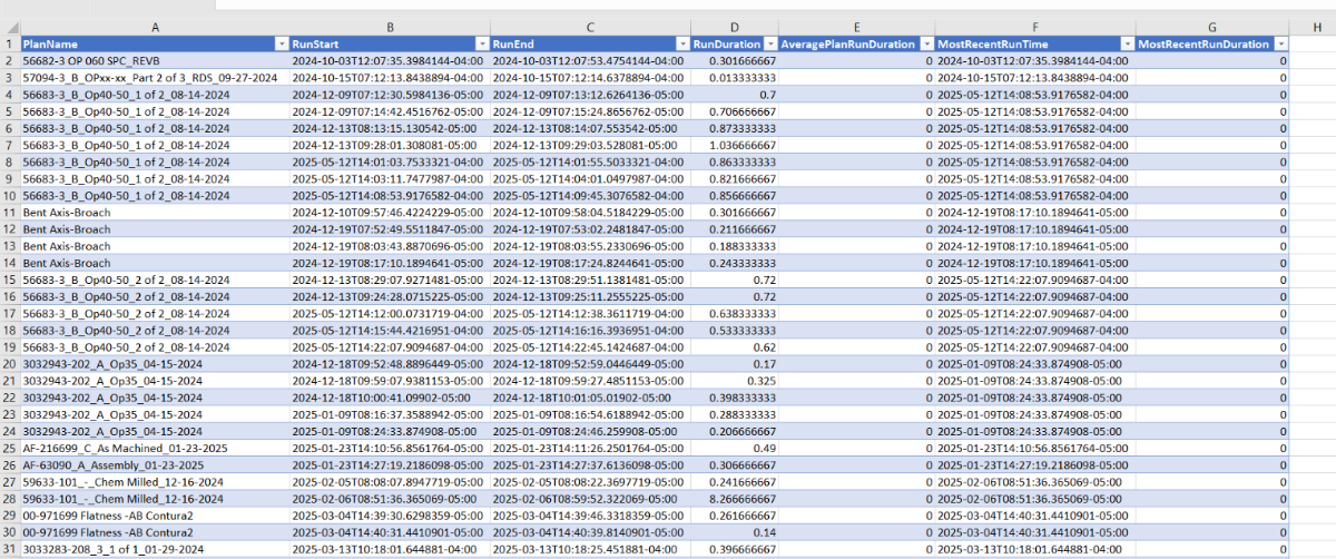

[Ja...] Posted May 15, 2025 Share Posted May 15, 2025 I know the home screen in Calypso shows the last 5 plans that were opened... Is there somewhere that would display say the last 10, 25, 50????? Was out of the office, and I like to keep tabs on runs/edits to any plans that were used... Thanks in advance. Link to comment https://qualityforum.zeiss.com/topic/23455-measurement-plan-last-used/ Share on other sites More sharing options...
[Ma...] Posted May 15, 2025 Share Posted May 15, 2025 I think you can not alter number of last opened programs. On path c:\ProgramData\ZEISS\Calypso x.x\users\YOUR_USER\config\env\values you can find your last 5 opened programs. Do periodical scans and you can get those infos. Not sure for programs runned in autorun Link to comment https://qualityforum.zeiss.com/topic/23455-measurement-plan-last-used/#findComment-132233 Share on other sites More sharing options...
[DW...] Posted May 15, 2025 Share Posted May 15, 2025 Please sign in to view this quote. Please sign in to view this username. Use PCM in the inspection pre load file to log each run to a text file. Link to comment https://qualityforum.zeiss.com/topic/23455-measurement-plan-last-used/#findComment-132235 Share on other sites More sharing options...
[Ma...] Posted May 15, 2025 Share Posted May 15, 2025 Addition to DWC answer - if you don't have PCM then batch files should work the same "inspection_post_load.bat" If you place this into inspection plan folder, then you know the name - or you can obtain it as "%0" ( like "echo %0" ) - placing it in inspection root folder i don't know if you can obtain caller path. Link to comment https://qualityforum.zeiss.com/topic/23455-measurement-plan-last-used/#findComment-132237 Share on other sites More sharing options...
[Ri...] Posted May 15, 2025 Share Posted May 15, 2025 (edited) Try this. Typical install location (Calypso 7.4 shown). C:\Users\Public\Documents\Zeiss\CMMObserver Load this file in Excel: ProgramDurationRecord.XML Edited May 15, 2025 1 Link to comment https://qualityforum.zeiss.com/topic/23455-measurement-plan-last-used/#findComment-132245 Share on other sites More sharing options...
